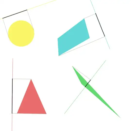

Define the width of a polytope $P \subset \mathbb R^d$ as the minimum length of the interval $\{v \cdot p:p \in P\}$ for $v$ in the unit sphere. In other words the width is the smallest number $W$ such that you can sandwich $P$ between two hyperplanes distance $W$ apart. Here's a picture: enter image description here
