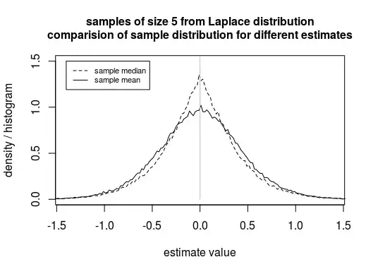

No, the sample mean is not always the best estimator. See for instance (besides the example of the mean of a uniform distribution by StubbornAtom) the case of a sample from a Laplace distributed population in the image below (code to compute that image is in this q&a)
showcase that median can be better than mean
In this image you see that the sample median can be a better estimator than the sample mean. Note that the distribution is more concentrated around the true location parameter (in this example this is 0).
