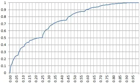

Below is a density satisfying all the requirements. Actually, the plot below represents its percentile distribution. It was produced with a seed $\alpha$ built as follows: its $n$-th binary digit is $1$ if $\mbox{Rand}(n) < 0.75$, and $0$ otherwise, using a pseudo random number generator. Note that $P._{25} = 0.5$ and corresponds to a dip ($P._{25}$ denotes the $25$-th percentile.) Dips are everywhere, only the big ones are visible. By contrast, the percentile distribution for the uniform case (if you replace $0.75$ by $0.50$ in $\mbox{Rand}(n) < 0.75$) is a straight line, with no dips.

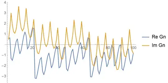

If we call:
$$G_n= -\log g(2^n), \qquad g(1)=1$$
Then the plot $G_n$ looks like this:
Not sure if this could lead to a non-trivial solution to the original equation though.

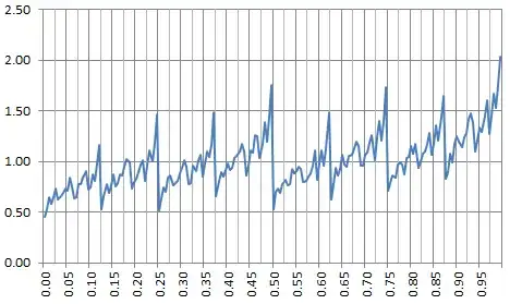

Here I discuss in more detail the case mentioned in the section "second update". This special distribution was produced with a seed $\alpha$ built as follows: its $n$-th binary digit is $1$ if $\mbox{Rand}(n)< p$, and $0$ otherwise, using a pseudo random number generator. I used $p=0.75$ in my example.
Now $x_n$ (introduced in the first paragraph in my question) is a random variable, and we have:
$$x_n=\sum_{k=1}^\infty \frac{d_{n+k}}{b^k}.$$
Here $b$ is the base ($b=2$), and $d_{n+k}$ is the $(n+k)$-th digit of $\alpha$ in base $b$. Furthermore, by construction, these digits are identically and independently distributed with a Bernouilli distribution of parameter $p$. Thus, using the convolution theorem, the characteristic function of $x_n$ is
$$\phi(t; p, b) = \prod_{k=1}^\infty \Big(1-p(1-\exp \frac{it}{b^k})\Big).$$
Take the derivative of the inverse Fourier transform (see section inverse formula here) and you obtain
$$f(x) = \frac{1}{2\pi} \int_{-\infty}^{\infty} e^{-ity} \phi(t; p,b) dy.$$
If $p=0.5$ and $b=2$ we are back to the uniform case. If $p\neq 0.5$ then the solution is quite special: the density $f$ is nowhere continuous it seems. See picture below for $p=0.55, b=2$.
Now we should prove that this case is ergodic, for the functional equation to apply. I also tried to check with some sampled values of $x$ to see whether $f(x) = \frac{1}{2}\Big(f(\frac{x}{2}) + f(\frac{1+x}{2})\Big)$, but the function being discontinuous everywhere, and since I got its value approximated probably to no more than two decimals, it is not easy. The distribution attached to this density has the following moments:
