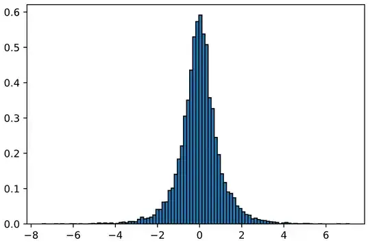

I have run simulations to get a feel of the answer
import numpy as np
import scipy as sc
import scipy.stats as stats
n = 30000 #summation index
m = 10000 #number of samples
X = np.random.normal(size=(m,n))
sums = np.cumsum(X, axis=1)
sums = np.delete(sums, -1, 1)
prods = np.delete(X**2-1, 0, 1)*np.abs(sums)
samples = 1/n*np.sum(prods, axis=1)
plt.hist(samples, bins=100, density=True)
plt.show()
Below is a histogram of $10.000$ samples ($n=30.000$). The variance from the generated samples is $0.9891$ (this complies with the computations above). If the limiting distribution was $\mathcal N(0,\sigma^2)$, then $\sigma=1$. However the histogram peaks at around $0.6$, while the max of the density of $\mathcal N(0,1)$ is $\frac 1{\sqrt{2 \pi}}\approx 0.4$. Thus simulations suggest that the limiting distribution is not Gaussian.

    My simulation also suggests that the limiting distribution may not be gaussian. Let us look at a similar problem that produces non-gaussian distribution. Let us replace $|S_{k-1}|$ by $S_{k-1}$ and $X_k^2 - 1$ by $X_k$. Then the resulting sum
    $$ \frac{1}{n} \sum_{k=1}^{n} S_{k-1} X_k $$
    converges in distribution to the Ito integral
    $$ \int_{0}^{1} W_s , \mathrm{d}W_s = \frac{W_1^2 - 1}{2}, $$
    where $(W_t)_{t\geq 0}$ is a Wiener process. Since $W_1 \sim \mathcal{N}(0, 1)$, this limiting distribution cannot be gaussian. Now I suspect that OP's problem also suffers the same issue.
    – Sangchul Lee Aug 24 '19 at 23:40
  • @JGWang The Laplace distribution with parameters $(0,1)$ has variance $2$, whereas the limiting variance should be $1$. Are you sure you're not mistaken ? – Gabriel Romon Aug 30 '19 at 07:12

  • @SangchulLee Does this limiting distribution match simulations ? – Gabriel Romon Aug 31 '19 at 07:09
    My simulation suggests that they are indeed equal. You may also try comparing two asymptotic distributions $$Z_n = \frac{1}{n}\sum_{k=1}^{n} |S_{k-1}|(X_k^2-1) \qquad\text{and}\qquad Y_n = \frac{1}{n}\left(2\sum_{k=1}^{n}S_{k-1}^2\right)^{1/2}X_k $$ for the purpose of numerical experiments by yourself. (Here, $Y_n$ converges to $\left(2\int_{0}^{1}W_s^2,\mathrm{d}s\right)^{1/2}N$ in distribution as $n\to\infty$. But since the limiting distribution is unlikely to have a closed-form, I chose to approximate it.) – Sangchul Lee Aug 31 '19 at 07:38
