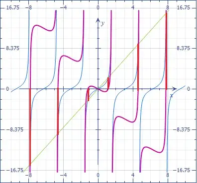

This transcendental equation does not have a closed-form formula and if the goal is to plot, there is no real benefit in computing those roots.
What you can do instead, is to plot the function $\tan x$, which has a well-known shape and is periodic, and find the intersections with $y=2x$ just graphically.
In any case, the roots are close to and odd multiple of $\dfrac\pi2$.
