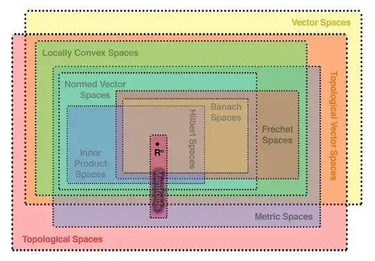

I was inspired by this flowchart of mathematical sets and wanted to try and visualize it, since I internalize math best in that way. This is what I've come up with so far:
Version 1 (old diagram)
Version 2: enter image description here
Is there anything that I'm missing, or that is incorrectly marked? For example, where exactly should I insert a box for Fréchet Spaces? And, is it safe to say that Normed Vector Spaces are a proper subset of the intersection between Locally Convex Spaces and Metric Spaces (or is it the entire intersection?)
Edit: Thank you, everyone, for your input. Obviously no single diagram is going to encapsulate the entirety of functional analysis, geometry, and topology (not to mention the myriad of algebraic structures I've ignored, as some of you have pointed out.) As someone who does a lot of analysis, I would often find myself going back to Wikipedia or my textbooks to re-read the definitions of the various spaces and sets I am working with. I just wanted something that could help me keep a lot of these ideas straight in my head; and was pretty and useful to glance at. I think I've settled on my final version (for now.) In summary, here is a quick bullet list of the labeled components of the diagram:
  • Topological Spaces: sets with a notion of what is "open" and "closed".
  • Vector Spaces: sets with operations of "addition" and "(scalar) multiplication".
  • Topological Vector Spaces: "addition" and "multiplication" are continuous in the topology.
  • Metric Spaces: sets that come with a way to measure the "distance" between two points, called a metric; the topology is generated by this metric.
  • Locally Convex Spaces: sets where the topology is generated by translations of "balls" (balanced, absorbent, convex sets); do not necessarily have a notion of "distance".
  • Normed Vector Spaces: sets where the topology is generated by a norm, which in some sense is the measure of a vector's "length". A norm can always generate a metric (measure the "length" of the difference of two vectors), and every normed space is also locally convex.
  • Fréchet Spaces: a set where the topology is generated by a translation-invariant metric; this metric doesn't necessarily have to come from a norm. All Fréchet spaces are complete metric spaces (meaning that if elements of a sequence get arbitrarily "close", then the sequence must converge to an element already in the space.)
  • Banach Spaces: a set that is a complete metric space, where the metric is defined in terms of a norm.
  • Inner Product Spaces: sets with a way to measure "angles" between vectors, called an inner product. An inner product can always generate a norm, but the space may or may not be complete with respect to this norm.
  • Hilbert Spaces: an inner product space that is complete with respect to this induced norm. Any inner product space that is incomplete (called a "pre-Hilbert Space") can be completed to a Hilbert space.
  • Manifold: a set with a topology that locally "looks like" Euclidean space. Any manifold can be turned into a metric space.

    are there inner product spaces that are Banach spaces but not Hilbert spaces? – J. W. Tanner Aug 18 '19 at 05:00
  • @J. W. Tanner Aren't all $L^p$ spaces inner product spaces when equipped with the $L^2$ inner product? It's just that $L^2$ is the only one of those that's also a Hilbert space. I think that's correct. – Patch Aug 18 '19 at 06:12

4 Answers4
16
My advice is to place a lot more landmarks like $\mathbb R^n$. Ideally, every area should have at least one point in it, which will serve to prove that the area really belongs there. It will also clarify what the relationships really mean. For example, all manifolds are metrizable, but not uniquely. So if you want "manifolds" to extend outside of "metric spaces", then you should add a landmark like $S^1$ and then, in a list of landmarks below the diagram, explain why it's there:
$S^1$ denotes the circle as a topological space. It is a manifold. It is not homeomorphic to any real vector space, since it is compact. It is metrizable, like all manifolds, but it doesn't come equipped with any particular metric.
Speaking of which, manifolds have a finite dimension, which is a topological invariant. So if a real manifold does have a real vector space structure, then it is a finite-dimensional vector space, and that may make it difficult to draw meaningful distinctions within all the little slices in the manifold box. Again, depending on what you really mean, you might be able to justify those slices, so I'm not going to say that they're wrong. Trying to place landmarks in there will force you to decide what you want them to mean.
Once you go through enough examples, then you can summarize the meanings in a preface to the diagram:
This diagram depicts X. One box is placed entirely inside another box if either Y or (when it makes sense) Z.
Chris Culter
  • 27,415
  • Honestly, I was unaware that all manifolds were metrizable. I was just going off the flowchart from Wikipedia for that one. In the revision I would keep "Manifolds" completely contained inside metric spaces. – Patch Aug 18 '19 at 05:53
    In general I agree about adding more concrete examples. Would you happen to know if there are any other improper inclusions? Particularly, is J. W. Tanner correct? Are all complete inner product spaces also Banach spaces? Or is there a space that has an incompatible inner product and norm, but is still complete? – Patch Aug 18 '19 at 05:57

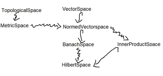

Your profile says you are a PhD Candidate, so perhaps you are interested in some more details. Also maybe this answer is a bit off-topic and a bit overly advertising! But I found the things below extremely helpful for my own understanding how mathematics can be structured (digitally).
I would like to elaborate on user87690's answer. They are correct that your diagram treats obvious inclusions, e.g. Vectorspace $\hookrightarrow$ NormedVectorSpace, in the same way as non-obvious "inclusions", e.g. TopologicalSpace $\hookrightarrow$ MetricSpace. Let me introduce you to the the theoretical side of some very general framework called MMT, which is able to exactly capture all those cases of "blah induces blub". In one sentence, one could say MMT is a scalable module system for mathematical knowledge management. Knowledge is organized into MMT theories and MMT morphisms (or short morphisms) -- but we'll get to this. Let's first start where your post ended.
(Disclaimer: I have contributed to and written about MMT in the past. However, I'd dare to say that the things you'll hopefully learn below will easily convert over to other mathematical knowledge management systems. They all have a notion of modules and interconnection between modules.)
Generalized Inclusions
The generalization of inclusions are so-called MMT morphisms written as $\rightsquigarrow$, e.g. $$\text{TopologicalSpace} \rightsquigarrow \text{MetricSpace}.$$ You can read this as "any metric space induces a topological space". The same holds true for ordinary inclusions $\hookrightarrow$, e.g. $$\text{VectorSpace} \hookrightarrow \text{NormedVectorspace}$$ can also be read as "every normed vectorspace induces a vectorspace", but it's special insofar that a normed vectorspace is the same as a vectorspace with additional things -- norms and norm axioms.
With this notation, I can give you a new picture:
New theory graph with adapted notation of inclusions (\hookrightarrow) and general MMT morphisms (\rightsquigarrow)
Note that there is no arrow from $\text{BanachSpace}$ to $\text{InnerProductSpace}$ precisely because the latter is not necessarily complete. Hence an incomplete inner product space cannot induce a Banach space, which is complete by the very definition!
I'd like to remark that one can compose MMT morphisms. For example, we can obtain a morphism $\text{TopologicalSpace} \rightsquigarrow \text{HilbertSpace}$ by composition! It would translate to your diagram as follows: if a box $B$ is in a box $C$, and the box $C$ is in a box $D$, then $B$ is also in $D$.

  • Of course it is just a convention, but it would seem more natural to me if the arrows depicting morphisms were going opposite way. You take a structure of natural numbers and turn it to a monoid structure, so the transformation is NaturalNumbers → Monoid. Of course you still define the transformation by defining every member of the target structure by the means of source structure. In the source code 'view σ : Monoid <- NaturalNumbers...' would be more natural to me. – Adam Bartoš Aug 18 '19 at 16:27
  • Also in your hand drawn diagram, the arrow between InnerProductSpace and HilbertSpace should be just an inclusion. And the arrow between VectorSpace and NormedVectorSpace is more like "forgetting" than just inclution, the signatures are different. – Adam Bartoš Aug 18 '19 at 16:31
  • @user87690 I can totally see where you are coming from regarding the morphism direction. I felt the same when I began learning this system. The idea is that for morphisms you have two sides of the medal: a syntax and a model side. MMT morphisms follow the syntactical direction and represent translation/specialization/refinement there. This gets evident if you consider the homomorphic extension $\bar{\sigma}$ for a morphism $\sigma$, which extends it to all closed well-typed domain expressions. Now consider you declared a theorem $thm$ together with a proof in $\text{Monoid}$... – ComFreek Aug 18 '19 at 18:51
  • … computing $\bar{\sigma}(thm)$ gives you the theorem's instantiation inside natural numbers together with the proof. There is an MMT meta theorem stating that this translated theorem and its proof are indeed well-typed, i.e. valid! Now, on the other hand, model-theoretic arguments work in the opposite direction. All models of the $\text{NaturalNumbers}$ theory induce a $\text{Monoid}$ model precisely in the way one might imagine. So forward direction = as above, backward direction = model induction... – ComFreek Aug 18 '19 at 18:54
  • Re your second comment: I agree, the one arrow should be an inclusion. Why are the signatures of VS and NVS different, though? NVS takes the signature of VS and extends it with one more declaration $norm: U \to \mathbb{R}$ and some norm axioms. Inclusions subsume signature extensions. (Perhaps you were coming from mathematical embeddings? The word inclusion is to be understood as importing the list of typed declarations of one theory. Literally as "#include theory.cpp" would do in C++.) – ComFreek Aug 18 '19 at 18:58
  • I just meant that extending a signature is still slightly more than just adding axioms – every normed space is a vector space if you forget the norm, but a Banach space just is a normed space. – Adam Bartoš Aug 18 '19 at 21:17
