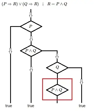

Still anoher way of looking at our problem shall be presented. For ease of notation, let's replace TRUE by $1$ and FALSE by $0$ in $(P \Rightarrow R) \vee (Q \Rightarrow R)$ with $R = (P \wedge Q)$. Then, with the sequential interpretation and all possibilities covered:
if (if P then R else 1) then 1 else (if Q then R else 1) : in general
if (if 0        else 1) then 1            [    ]         : P = 0
if (if 1 then 0       )        else (if 0 [    ] else 1) : P = 1, Q = 0
if (if 1 then 1       ) then 1            [    ]         : P = 1, Q = 1
So for the second instance of $R$ we have, with all possible (0,1) specifications, empty spots [ ]; it is like the second instance of $R$ it is not there at all! The accompanying Flowchart is in concordance with this observation:

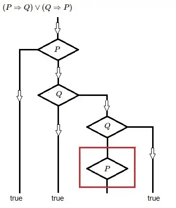

As a second example, consider the tautology $(P \Rightarrow Q) \vee (Q \Rightarrow P)$.
The sequential version is, with 0 = FALSE and 1 = TRUE and all possibilities exhausted:
if (if P then Q else 1) then 1 else (if Q then P else 1) : in general
Empty spots [ ] again. So the second instance of P is obviously redundant. As is clear as well from the Flowchart:

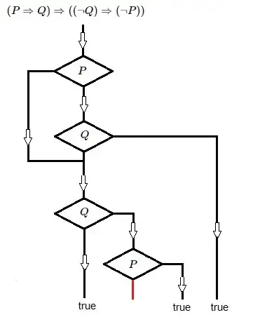

Time to present a counter example: $(P \Rightarrow Q) \Rightarrow (\neg Q \Rightarrow \neg P)$.
if (if P then Q else 1) then (if -Q then -P else 1) else 1 : in general
if (if 0        else 1) then (if  1 then  1       )        : P = 0, Q = 0
if (if 0        else 1) then (if  0         else 1)        : P = 0, Q = 1
if (if 1 then 0       )                             else 1 : P = 1, Q = 0
if (if 1 then 1       ) then (if  0         else 1)        : P = 1, Q = 1
All instances of P and Q are decidable, none of these is redundant.
The tautology   IF(IF P THEN Q) THEN (IF NOT Q THEN NOT P)   is acceptable in common language as well. In the Flowchart all decisions are useful:

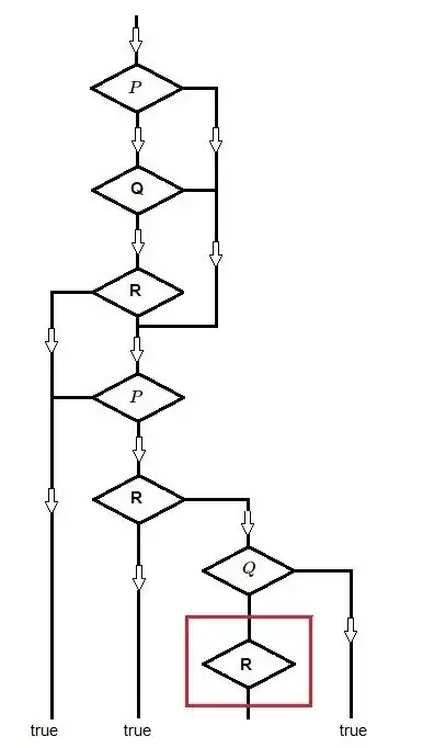

Unfortunately, the author has made a little mistake while trying to reproduce the problem from the article by Emanuel Rutten. What's actually in there is this: \begin{cases} \mbox{[1*] } P \wedge Q \Rightarrow R, \\ \mbox{[2*] } (P \Rightarrow R) \vee (Q \Rightarrow R). \end{cases} Here $P =$ “Brigitte has yellow paint”, $Q =$ “Brigitte has blue paint” and $R =$ “Brigitte can mix green”.
The calculus of propositional logic does render the argument form [1*]-[2*] logically valid.
The above may be concisely written as: $$ ((P \wedge Q) \Rightarrow R) \Rightarrow ((P \Rightarrow R) \vee (Q \Rightarrow R)) $$ Which is slightly different from what's stated in the question, where $\;R = (P \wedge Q)\;$ or $\;R \Leftrightarrow (P \wedge Q)\;$, where it should have been $\;R \Leftarrow (P \wedge Q)\;$.
With the sequential interpretation, as explained in the question, it reads, step by step: $$ \mbox{ if }(P \wedge Q \Rightarrow R) \mbox{ then } (P \Rightarrow R) \vee (Q \Rightarrow R) \mbox { else } 1\\ (P \wedge Q \Rightarrow R) \; \equiv \; (\mbox{ if } (\mbox{ if } P \mbox{ then } Q \mbox { else } 0) \mbox{ then } R \mbox { else } 1)\\ (P \Rightarrow R) \vee (Q \Rightarrow R) \; \equiv \; (\mbox{ if } (\mbox{ if } P \mbox{ then } R \mbox { else } 1) \mbox{ then } 1 \mbox { else } (\mbox{ if } Q \mbox{ then } R \mbox { else } 1)) $$ Flow chart and specification for all (0,1) values of (P,Q,R) are slightly more complicated than before.
But the end-result is the same: the last instance of R is redundant (: $\color{red}{\mbox{red box}}$ [ ] ).
if (if (if P then Q else 0) then R else 1) then (if (if P then R else 1) then 1 else (if Q then R else 1)) else 1 : general
if (if (if 0        else 0)        else 1) then (if (if 0        else 1) then 1            [    ]                 : P = 0
if (if (if 1 then 0       )        else 1) then (if (if 1 then 0       )        else (if 0 [    ] else 1))        : P = 1 , Q = 0 , R = 0
if (if (if 1 then 0       )        else 1) then (if (if 1 then 1       ) then 1            [    ]                 : P = 1 , Q = 0 , R = 1
if (if (if 1 then 1       ) then 0                                                         [    ]          else 1 : P = 1 , Q = 1 , R = 0
if (if (if 1 then 1       ) then 1       ) then (if (if 1 then 1       ) then 1            [    ]                 : P = 1 , Q = 1 , R = 1
