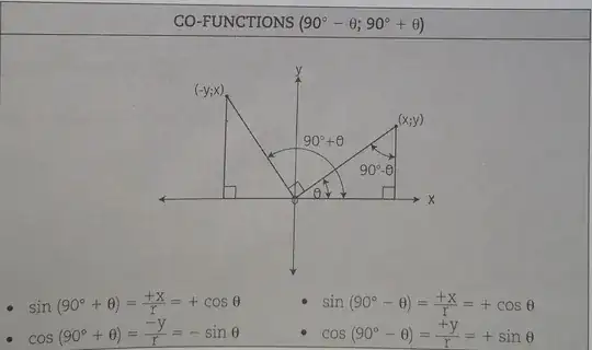

How are these reduction formulas derived?
$$\sin(90°+θ) = +\cos(θ)$$ $$\cos(90°+θ) = -\sin(θ)$$
The source of the formula.
I understand how to reduce angels that fall into the $2^{nd}$, $3^{rd}$, and $4^{th}$ quadrants to be expressed in the $1^{st}$ quadrant at $180°$ and $360°$ differences but not at $90°$.
Thanks for the help.

take a point $(x,y)= (r\cos \theta, r\sin \theta)$. Rotate your plane $90$ degrees counter clockwise. The point will have moved from $(x,y)$ to $(-y, x)=(r\cos (\theta + 90), r\sin (\theta + 90))$.
So $r\cos (\theta + 90) = -y$ and $r\sin (\theta+90) = x$.
That's all.
Okay, why does $(x,y) \mapsto (-y, x)$?
Well.... draw the line from $(x_0,y_0)$ to $(0,0)$, That line has the formula $y = \frac {y_0}{x_0} x$ and slope of $m= \frac {y_0}{x_0}$. A line that is $90$ degrees from this to the origin will have a slope of $-\frac 1m = \frac {x_0}{y_0}$. If you move along the perpendicular line with the perpendicular slope the same distance of $r = ||(x_0, y_0), (0,0)|| = \sqrt {(x_0-0)^2 + (y_0-0)^2}$ you will get to the point $(-y,x)$.
Or in other words:
$(x,y)$ is the result of going to the right $x$, and going up $y$. If you rotate that $90$ degrees, you will be going up the same distance you used to go right. So you'll go up $x$. And you'll go left the same distance you used to up. So you'll go $y$ to the left--- of $-y$. So you'll end up at $(-y, x)$; which is going to the left $y$ and up $x$.

The OP posted this picture:
which is kind of ugly and not very clear.

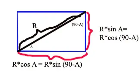

But the posted answer has this picture:
which I think is just beautiful and utterly clear.

let's have a breakdown in the comments made a VERY interesting point that "co-sine" literally means "sin of the complimentary angle" so by definition $\cos A = \sin (90 -A)$.
The question is if $(x,y)$ is a point where $R= ||(x,y)||=\sqrt{x^2 +y^2}$ so that we have $y = R*\sin A$ (by definition of "sine") then why would it follow that $x$ should equal $r*\sin (90-A)= R*\cos A$.
Which encouraged me to create the following image which should make that clear.
If $y = R*\sin A$ then it follows that $x = R\sin (90-A)$.
We can either define $\cos A = \frac yR$ or we could define $\cos A = \sin (90-A)$. But the picture should explain why those two values are always the same.
