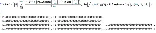

I found a related sum with Mathematica, using numerical experiments (linear fit actually helped):
$$\sum _{m=1}^{2N-1}(-1)^m \frac {m}{2N} \left[ \psi \left(\frac {m}{2N}\right)+\frac {\pi }{2} \cot \frac {\pi m}{2N} \right] =\frac {\gamma }{2}+ N \log 2$$

    I read you question with much interest, because I'm currently working on a new digamma infinite sum. The only hint I have for you - lack of time - is $$\frac{1}{2} \left(\psi \left(-\frac{m}{2 N}\right)-\psi
    \left(\frac{m}{2 N}\right)\right)=\frac{N}{m}+\frac{1}{2} \pi
    \cot \left(\frac{\pi m}{2 N}\right)$$ $$\sum _{m=1}^{2 N-1} \frac{(-1)^m m \left(\psi \left(1+\frac{m}{2 N}
    \right)+\psi \left(1-\frac{m}{2 N}\right)\right)}{4 N}+\frac{1}{2}=N
    \log (2)+\frac{\gamma}{2}$$
    – stocha Jul 29 '19 at 10:14
