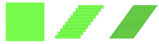

Behold, $\phantom{proof without words}$

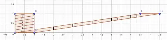

Slice each figure by infinitely many infinitely thin horizontal layers. The area of each slice is the same as that of the corresponding slice in the original square: corresponding slices both have the same width and height and the ends can be neglected (in the given limit).
    Seems circular. You would like to say exactly the same thing about the thin slices as you would for the whole, but you don't have it yet (unless you assume the conclusion.) – rschwieb Jul 24 '19 at 19:26
    Agree with @rschwieb . You may want to put something in about the thin horizontal slices being just straight up rectangles instead of sheared rectangles on top of one another, so that they could've also been gotten in the original square, and as we make them infinitely small, the "empty space" due to having to shift over the ones getting stacked on top approaches 0? – joshuaronis Jul 24 '19 at 20:02
    Not circular at all, though I clarified the answer to include this. – David G. Stork Jul 24 '19 at 21:49
    @DavidG.Stork Taken at face value it was circular... but I see now you have expanded it to a sketch of Cavalieri’s principle, yes. – rschwieb Jul 25 '19 at 01:07

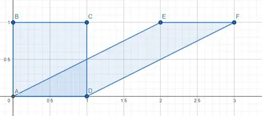

Just for completeness, here is another method of disection that proves the result. parallelogram disection
Paul Sinclair
  • 45,932
    Beautiful! Looks the distance between the lines approaches $0$ as FG goes to the right extreme.. making the width of the slices in the square also approach $0$. – AgentS Jul 26 '19 at 08:38
    @rsadhvika The width of the slices approaches zero, but, at the same time, the number of slices approaches infinity, such that the number of slices is propotional to the inverse of the widths. – Vaelus Jul 26 '19 at 15:33

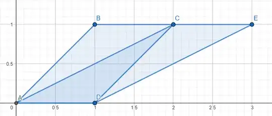

You can do the trick you used in your third example, where you can "move a triangle" to get to the other parallellogram multiple times. For example: enter image description here
We can do this in 2 simple steps:
step 1: just moving a triangle step 1: just moving a triangle
step 2: moving a triangle again step 2: moving a triangle again
Stijn
  • 477
    @JahanClaes I disagree. This proof, like the "easy to see" first example in the question, needs no information about the area of the triangle beyond the fact that the area is unchanged when you translate the triangle. In the answer's last figure, all that's needed is that triangles ABC and DCE have the same area (nothing about ADC, which would indeed be circular reasoning). – Andreas Blass Jul 26 '19 at 00:55
    I like this one a lot. Somehow induction is more satisfying to visualize than the other visual "proofs". – Vaelus Jul 26 '19 at 15:37
    @AndreasBlass Withdrawn! I didn't think about the figure long enough to realize that in figure 2 the triangles were still congruent. Now this one is my favorite. – Jahan Claes Jul 26 '19 at 16:09
    This doesn't work so nicely if the $x$-coordinate of $E$ in the first diagram is irrational. – aschepler Jul 27 '19 at 10:49
    @aschepler: In that case it doesn't get you to a square, but it still gets you to a parallelogram with an internal altitude: that is, the "easy to see" diagram in the question. – Micah Jul 28 '19 at 00:52

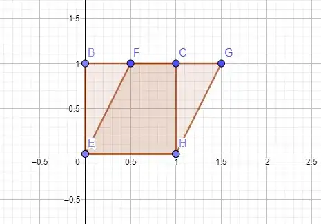

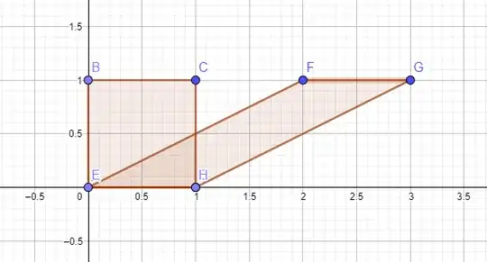

In your first two figures, note that $$\text{area}(EBGH)=\text{area}(EBCH)+\text{area}(HCG)$$ and $$\text{area}(EBGH)=\text{area}(EFGH)+\text{area}(BEF).$$ But the triangles $HCG$ and $BEF$ are congruent, so have the same area. Subtracting that gives $$\text{area}(EBCH)=\text{area}(EFGH).$$ Come to think about it, this works just as well in the third figure.
Angina Seng
