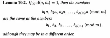

So by this motivation, i examined proof of the Euler's Theorem for $U(n)$ and looked up if i can generalize this proof. And i have seen that whole proof depends on the lemma,
Lemma 10.2
So we can generalize the lemma as follows:
If $a \in G$ (i.e. satisfies the properties which holds true for all elements of $G$, like $(a, n) = 1$ for $a \in U(n)$), then the sets formed by sequences,
$$p_1, p_2, ..., p_i, ..., p_{|G|}$$
and $$ap_1, ap_2, ..., ap_i, ..., ap_{|G|}$$ (where $p_i$ is each element of $G$) are the same.

Your proof almost works, but unfortunately it falls just short.
The reason it doesn't work is the equality of products you wrote : in fact the sequences are not the same; they have the same elements but possibly (and in fact almost all the tim) not in the same order.
So if $G$ is not commutative, i.e. if the order in which you multiply matters (this is the case for $S_n$ and $D_{2n}$ ), then you can't equate the two products.
So your proof works if $G$ is a commutative group.
However, the result is correct, even if the group is not commutative, the proof will simply have to be different. It is a corollary of Lagrange's theorem, you may want to look that up if you're interested.
