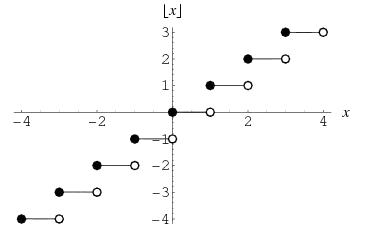

Another way to think about this integral is to consider the form
$$\int_{-n}^0 \lfloor x\rfloor \ dx$$
which can be visualized by the step function
The area underneath this function from $-x$ to $0$ is
$$ -x -(x+1) -(x+2) - \dots -3 -2 -1 $$
Now, since
$$\int_{-n}^0 \lfloor x\rfloor \ dx = \int_{0}^n \lfloor -x\rfloor \ dx$$
and
$$\int_{-n}^0 \lfloor x\rfloor \ dx = \sum_{k=1}^n (-k)=-\frac{1}{2}n(n+1)$$
We see that
$$\int_{-1}^0 \lfloor x\rfloor \ dx = -\frac{1}{2}(2) = -1 = \int_{0}^1 \lfloor -x\rfloor \ dx$$
