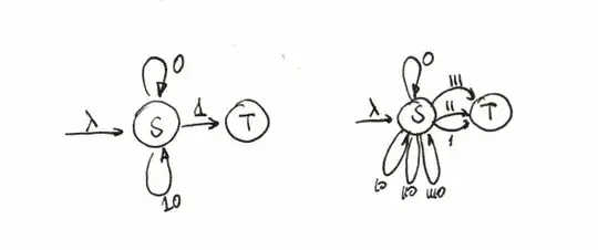

The generating function for binary (red-blue or 0-1) n-sequences that do not contain k-substrings of 1' is
$$ 1-y^k \over 1-x-y-xy^k $$
two factories
By using "factory diagrams" to generate sequences that do not contain k-strings of 1's, we get for $k=2$ (left diagram) $ S= 1 + Sx + Syx $ for sequences that do not contain 11's and end in 0, then $T = Sy$ for sequences that end in $1$. Hence the $S+T$ generating function.
Generaly (right diagram), $ S= 1 + Sx + Syx + Sy^2x +...+ Sy^{k-1}x $ and $T= S(y + y^2 +...+ y^{k-1})$
Boyku
  • 740
  • I'm not sure I understand how you get the generating function. I guess the result should depend on the number of 0/1. Also what are $x$ and $y$ ? – qdr Jul 23 '19 at 14:11
  • Oh dear me, it is a long story. For example, the generating function for the set $ { \lambda, 0, 1, 00, 11 }$ is $1+x+y+x^2 +y^2$. The automatons and grammars are just another way to depict this kind of structures. – Boyku Jul 24 '19 at 00:30
