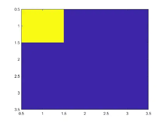

I ran some quick calculations just to get a feel for the magnitudes of the numbers1. Here's an animation of Langton's ant on a $3 \times 3$ torus, where the cycle takes 22 steps: gif of 3x3 langton's ant
