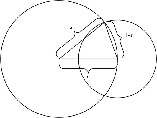

The probability of a point at a distance $r$ from the center of the circle of radius $1$ being in a circle of radius $s$, whose center is uniformly distributed in a circle of radius $1-s$ concentric with the circle of radius $1$, is the ratio of the area of the intersection of a circle of radius $1-s$ with a circle of radius $s$ whose centers are at a distance $r$ divided by the area of the circle of radius $1-s$.
Using the Law of Cosines and Heron's formula, we get $$ \rho(s,r)=\left\{\begin{array}{} 1&\text{if }r\le2s-1\\[12pt] \frac{s^2}{(1-s)^2}&\text{if }r\le1-2s\\ \frac{s^2\cos^{-1}\left(\frac{r^2+2s-1}{2rs}\right)+(1-s)^2\cos^{-1}\left(\frac{r^2-2s+1}{2r(1-s)}\right)-\frac12\sqrt{\left(1-r^2\right)\left(r^2-(2s-1)^2\right)}}{\pi(1-s)^2}&\text{if }r\gt|1-2s| \end{array}\right. $$

Symmetry says that the density will be radially symmetric, so we will evaluate at the point $(r,0)$.
Consider $$ \frac1{\pi(1-s)^2}\iint\overbrace{[|t|\lt1-s]}^{t\in B(1-s,0)}\,\overbrace{[|x-t|\lt s]}^{x\in B(s,t)}\,\mathrm{d}t\,\delta(x-(r,0))\,\mathrm{d}x $$ Integrating in $t$ first, we get the average of a disk of radius $s$ whose center has been placed uniformly in the disk of radius $1-s$ centered at the origin. Integrating in $x$, against the delta function, we get evaluation of the resultant average at the point $(r,0)$. This gives the average inclusion probability at $(r,0)$.
The substitution $t\mapsto x-t$ yields $$ \frac1{\pi(1-s)^2}\iint[|x-t|\lt1-s]\,[|t|\lt s]\,\mathrm{d}t\,\delta(x-(r,0))\,\mathrm{d}x $$ and now we can apply Fubini to change the order of integration $$ \frac1{\pi(1-s)^2}\iint[|x-t|\lt1-s]\,\delta(x-(r,0))\,\mathrm{d}x\,[|t|\lt s]\,\mathrm{d}t $$ Integrating in $x$ yields $$ \frac1{\pi(1-s)^2}\int[|(r,0)-t|\lt1-s]\,[|t|\lt s]\,\mathrm{d}t $$ which is the area of the intersection of a disk of radius $s$ and a disk of radius $1-s$ whose centers are separated by a distance $r$ divided by area of a disk of radius $1-s$.
