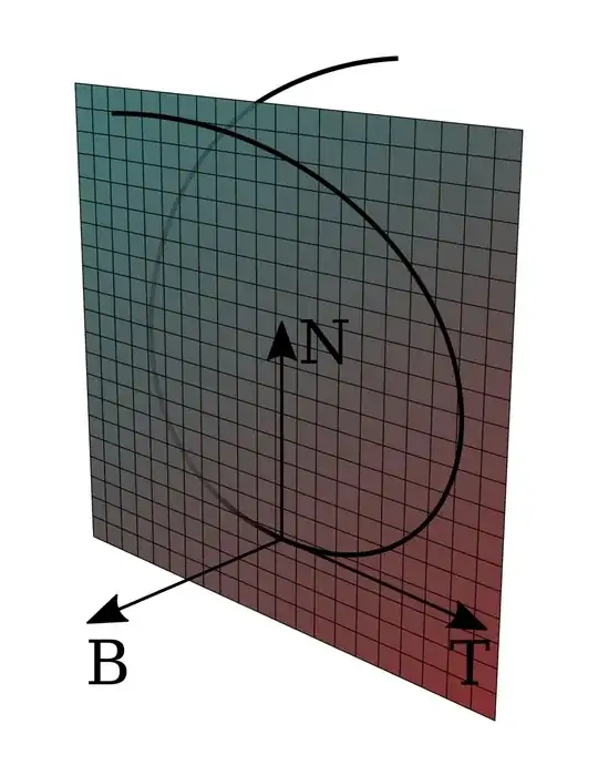

Let's say that I have numerical data for a curve in $\mathbb{R}^{3}$, but I do not have the parametric equations of the curve; all that I have is a sampling of $N$-many points that lie on this curve, $R_{i}=[x_{i} \, y_{i} \, z_{i}]$ for rows $1\leq i \leq N$. How would I numerically determine the normal, binormal, and tangent vectors for each point along this curve?
I do know the direction that points on the curve travel, and so I can numerically compute/approximate the tangent vector using, say, a central difference scheme:
$$\vec{T}v_{i} \approx \frac{v_{i+1}-v_{i-1}}{2\Delta t},$$
where $\Delta t$ is the time delay in the sampling of this parametric curve (and $i$ runs $2 \leq N-1$).
Conventionally, the binormal and directions require the parametric equation(s) of motion in order to be computed (e.g., the Frenet-Serret Equations). Are there methods for numerically approximating the normal $\vec{N}$ and binormal $\vec{B}$, just as I have numerically approximated the tangent vector $\vec{T}$ at $v_{i}$?
The key, I think, is the normal vector because once $\vec{N}v_{i}$ and $\vec{T}v_{i}$ have been found, $\vec{B}v_{i}$ can then be computed by its definition as $\vec{B} = \vec{T} \times \vec{N}$. In particular, $\vec{N}$ should be orthogonal to $\vec{T}$ and $\vec{B}$, and it should point in the direction that the curve bends. This refers to the direction in which the curve deviates from straight line motion. The binormal vector points in the direction around which the tangent vector turns.

  • @WimC (and Daniel Schepler) - I like your thoughts, which seem convergent to the same idea. Using splines is an interesting suggestion, but I wonder if it would be computationally expensive. I've edited my question to provide more background on the normal vector $\vec{N}$. My gut tells me that the properties of $\vec{T}$, $\vec{N}$, and $\vec{B}$, and the relationships between these vectors, should give us a way to numerically approximate these vectors using only this information. What do you think? – matt1011 Jul 12 '19 at 11:23

Having asked those questions, which I beg you not to ignore, you can pretend everything is fine and then there's a nice solution: to compute the normal at point $i$, look at the points $P_{i-1}, P_i, P_{i+1}$; these three lie on a plane, and the curve normal is the vector in that plane that's closest to being orthogonal to the tangent. Letting $v = P_i - P_{i-1}$ and $u = P_{i+1} - P_i$m the normal to the plane (not the curve normal!) is $n = u \times v$, and you can then approximate $N$ (the curve normal) as $N = \pm n \times T$ (I leave you to work out the sign). By the way, the vector $\pm n$ (again, you get to work out the sign) is a good approximation of the binormal (once you make it a unit vector).

  • Thank you for your thorough reply. Very helpful and informative$\ldots$ Follow up question: in a Frenet Frame, is it not true that the normal vector should point in the direction of the curvature? When I implement your numerical suggestion of $N=\pm n \times T$, my normal vector points away from the curvature direction (c.f., the image embedded in my original post). Without resorting to having to look at $N$ and retroactively recognize that it is inversely-pointing, is there a numerical way to preemptively calculate $N$ so that it points in towards the curvature of the curve? (thanks!) – matt1011 Jul 29 '19 at 20:24
  • Oh, hell. I probably got the sign wrong. I did write $N = \pm n \times T$. Presumably if it points away when you use a + sign, it'll point towards if you use as $-$ sign. And if this works for one curve, it should work for all of them. So get that one sign right, and you're good to go – John Hughes Jul 30 '19 at 18:12
  • Thanks, but is there a way to numerically determine the correct sign for $N$? When I visually plot the points, I can see whether the normal vector $N$ is pointing as it should, and I can then adjust accordingly with a minus sign. Is there a way to automate this? Is there a numerical test to see if $N$ is already pointing in the direction of the curvature of the curve? Once I have $N$ oriented correctly relative to $T$, then $B$ quickly follows via the cross product of $T$ and $N$. – matt1011 Aug 04 '19 at 02:07
