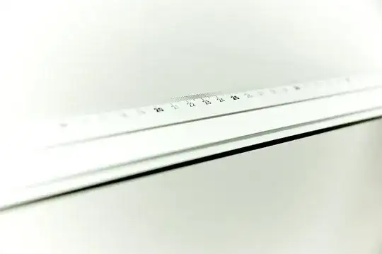

So first things first, we need to get the intuitive part into place, and that means thinking a little bit about what the real number line "is", and what we seek to prove in relation to that.
And this is how it goes. The real number line should, basically, be thought of as an "idealized ruler": a ruler, as you might know, has little tick marks at regularly-spaced intervals along it, like this. courtesy: "fjords", https://www.flickr.com/photos/fjords/1371280675, cc-by-sa 3.0.
You should also note that every so many marks, there is a "large" mark that is marked with a whole number. This represents a count of the ruler's fundamental unit - here it is (I presume) centimeters (cm). In the mathematical real number line, we don't care what that unit actually is, if it is anything at all, only that it exists: and we denote it with the symbol $1$ - this is why you may have heard "$1$" called "the unit" or "unit", as that is what it is: on the ruler, the tick marked "$1$" means $1\ \mathrm{cm}$.
Moreover, there are small marks. On a ruler like the above, they are millimeters, or better, tenths of centimeters: each small tick counts $\frac{1}{10}\ \mathrm{cm}$. We use the marks as thus: by counting - either the larger or smaller marks - from the ruler's start point, up to some desired end point, such as, perhaps, the end of a long object which the ruler is placed against, we can figure out the number of measuring units of that type (i.e. $1\ \mathrm{cm}$ or $\frac{1}{10}\ \mathrm{cm}$). For example, if we count 23 of the large marks, we know it is 23 cm. Note that the same would also be the case if we counted 230 of the small marks: that is $\frac{230}{10}$ cm. This shows that the ruler has two different levels of precision, and this would be a more precise measurement: if the object is not exactly 23 cm long, but its end fits between 22 and 23 cm, say, we can now get the nearest tenth, e.g. 22.7 cm.
The real number line, likewise, works the same way, only it is far more detailed. In addition to the basic unit, you can think of it also having "tick marks" at any fraction thereof:
