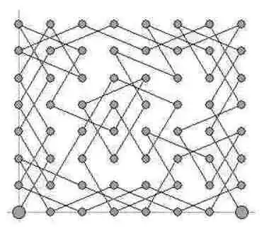

Yes, your reasoning is correct. As for a knight's tour from one corner to the other corner on the same edge, here's a very blurry image I found on the Internet. (The two large circles indicate start and finish.)
grid

    Interesting but I would appreciate a mathematical approach to prove that this is possible. – Tapi Jun 30 '19 at 13:27
    @Tapi This tour, in particular, was generated using Warnsdorff's Rule, which is a heuristic method saying you should always move your knight to a square which has the least onward moves. – Infiaria Jun 30 '19 at 14:23
