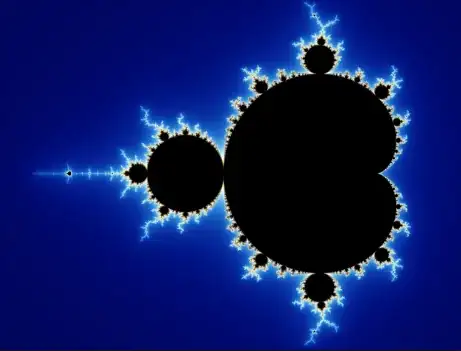

A mandelbrot fractal (I call it "operation order 1") is done by iteratively calculating complex number $Z(n+1) = Z(n)^2 + C$, $Z(0)=0$, $C$ is zoomed and offset screen coordinate. After an infinite number of steps (supertask) we do determine, wherether series for a pixel - does series converge or diverge? and "how fast" does it diverges? Faster are colored by blue, slower - by white. For non-divergent $C$ pixels, belonging to Mandelbrot Set - are black:

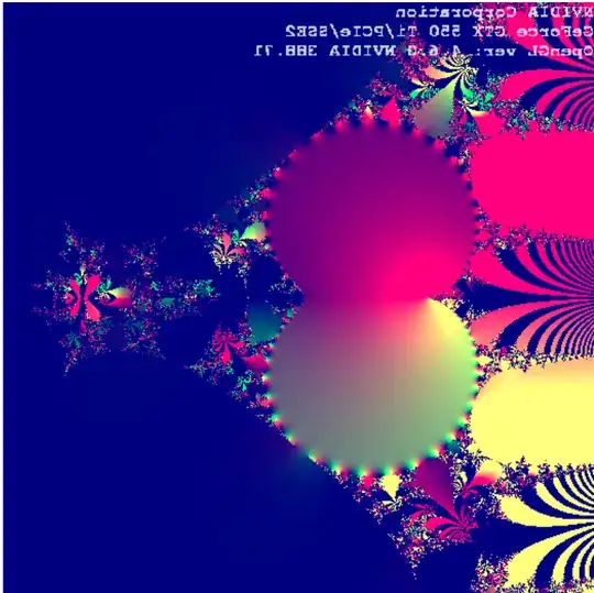

Then, we may proceed to next order, in hyperoperation sequence, and produce "operation order 2" fractal, by iterated exponentiation $Z(n+1)=c\exp(Zn)*C$, basically resulting in this:

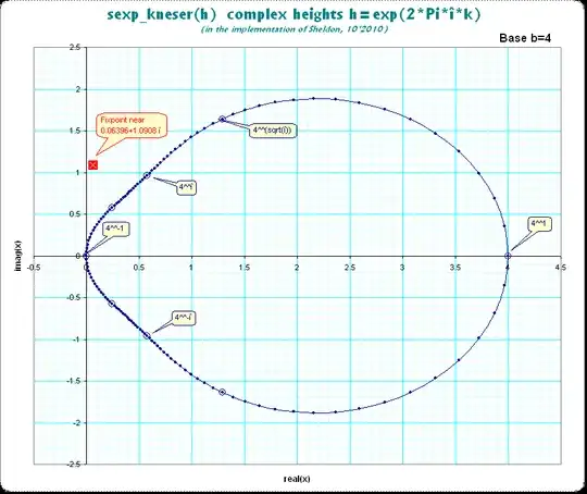

This is not an answer, just a comment, but having an image in it
Here is an example of complex heights. I've the base $b=4$, initial value $z_0=4$ . Then -in steps of 128- computations for heights $h=1, \cdots, h=I , \cdots, h=-1 , \cdots, h=-I , \cdots, h=1$ with $h$ on the complex unit circle. (The computations are done with a version of the Kneser-ansatz for bases $b$ larger than $b=e=\exp(1)$ (the choice in Kneser's original text) programmed by the tetration-forum member S. Levenstein). You might not yet have an idea how iteration with complex heights looks in a trajectory. Here is one picture.
You can see, that from $z_k= \;^{\exp(2\pi I \cdot k/128)}4$ with $k=0$ and $z_0=4$ the trajectory does roughly an egg-formed path via $z_{64}=0$ back to $z_{128}=4=z_0$.
I don't know whether such a trajectory would really be useful for your project-intentions... Is it anyway?
remark: I'd like more to use the notation $$ \exp_{\log 4}^{\circ h_k} (z) \text{ with } h_k=\exp(2 \pi I \cdot k/128) \text{ and } z=1 $$ but for whatever reason the public prefers the less expressive notation $^h 4$ .
remark 2: the legend of the image does not perfectly fit.
In the title it should be
"$\small \exp(2*Pi*î*k/128)$ for $\small k=0..128$"
and the x/y-legends should contain "z" instead of "x".
It's an older picture, just reused.

  • I know, I just wanted to make sure that's really what you want... I thought it might be that that closed curve uncovers some otherwise hidden problems... The code for the computation is due to Sheldon Levenstein as given to the tetration-forum and written in Pari/GP. I have a much simpler idea how to compute this, but what gives at best approximations to some 5 to 10 decimal digits to SL's computations. It involves matrix-diagonalization and complex arithmetic (which is possible for instance in Pari/GP) – Gottfried Helms Jul 13 '19 at 14:41
