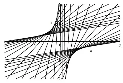

With the initial condition $z(x,0) = f(x) = x$, the solution deduced from the method of characteristics reads indeed $z = x-z^2 y$ in implicit form. Since this is a quadratic equation, we can easily analyze the number of solutions from the computation of the discriminant $\Delta = 1+4xy$, which we want to be non-negative for existence. From the two real roots $z = \frac12 (-1 \pm \sqrt{\Delta})/y$, only the '+' solution is compatible with the initial condition. Therefore the classical solution to the IVP is uniquely defined in the region $\Delta \geq 0$ where we have $z = \frac12 (-1 + \sqrt{\Delta})/y$, and there is no solution outside. A plot of the base characteristic lines in the $x$-$y$ plane is given below:
characteristics
The characteristic lines are included in the region $\Delta \geq 0$, located between the hyperbola branches $y = -1/(4x)$. Those hyperbola branches appear to be the caustic envelope of the characteristic lines, and they mark the boundaries of the accessible region of the $x$-$y$ plane. The region $\Delta < 0$ is not a shock region, but a region of the $x$-$y$ plane which is inaccessible. To some extent, this problem is quite similar to this one.
