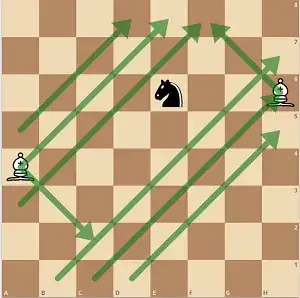

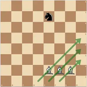

The wall here cannot move on its own without creating gaps. To still ensure that the knight can never jump the wall, we will make use of the fact that the knight can only ever jump on a square of the dual colour of his current square. We describe the sequence for the wall of two white-square and one black-square bishop(s). In all the following pictures, white is to move. It is important that the knight is on a black square. The green arrows will represent the wall.
step 1
The exact position of the knight is only an example here. White first moves the middle bishop. EDIT: Moving the middle bishop might runs into problems. As ArsenBerk pointed out, one should move the bishop that is furthest back first (and only then the middle one. This is only problematic as long as the knight is on a black square in the diagonal directly infront of the wall. In that case, move the other wall.
step 2
Right now, there is a gap in the wall, but as the knight was on a black sqaure, he could not take advantage of this. Next white moves the back bishop to build the new face of the wall.

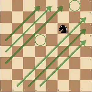

step 3
The same sequence just mirrored will enable the three bishops to get back to the starting position of three bishops in a row.
If the knight ever comes close to a group of bishops, we just move them far away along the wall without moving the wall.

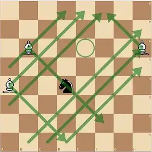

  1. Mate as follows:
We will drag one bishop down the wall to challenge the knight.
mate 1
For the sake of illustration, we assume he moves down. (The board is shifted to the up and right now).
mate 2

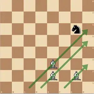

We will now block the road down for the knight, but to avoid stalemate, we leave one square for the knight to move to.
mate 3

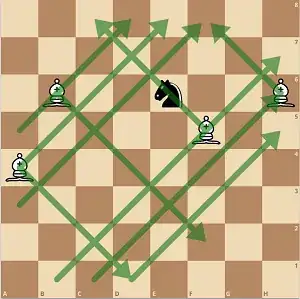

We immediately challenge the knight, leaving only one square open.
mate final
This is the final mating position. Observe that no bishop is ever under attack in this sequence and that (execept for the initial up or down choice) all moves are forced for black.
