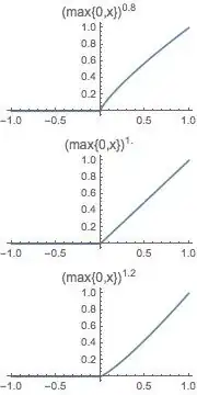

The slope of your function is zero on $(-\infty,0)$ (see the image below). For it to be differentiable at zero, its slope has to be zero on the right side as well. Your function restricted to $(0,\infty)$ is given by $x^n$. All you need is to show that the slope of $x^n$ at zero is zero for $n>1$.
- 2,688
