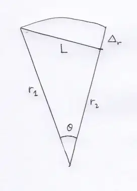

I have to place a series of line segments along an $r=k\theta$ spiral. All the line segments are the same length (which I will call $L$) and the starting point of each is the finish point of the previous.
For my task I decided it will be easiest to do if I can determine the next radius $r_2$ from the previous radius $r_1$ (or the angle $\theta$ from the previous radius $r_1$).
$ \hskip 2.0 in$enter image description here
So, I have the equations:
$r_2 = r_1 - \Delta r$
$\Delta r = k \theta$
and of course all the triangle relations from $\theta$ being between $r_1$ and $r_2$ and opposite $L$.
I plugged them together to get $r_1-k \theta=r_1\cos(\theta)\pm\sqrt{L^2-r_1^2\sin^2(\theta)}$
So, I need to solve for $\theta$ to get my $\theta$ and $r_2$. But, I don't know how to do this and the online solvers can't manage it (although they can solve very close ones...) Can anyone help with it?
Thank you!

It might be easiest simply to do it numerically -- write a parametric equation for your spiral and use bisection (or possibly Newton-Raphson) to find the parameter for the next point that has the desired distance from your current one.
  • Thank you Henning. I would love to write a little script to do it, but unfortunately I have to plug it into my CAD program so it would be ideal if I could get a closed form solution. Or even an approximate algebraic solution. – user183966 Jun 18 '19 at 16:22
  • @user183966: I think you're out of luck for a closed-form solution. The law of cosines gives something only slightly nicer than your equation -- there's no square root, but still a mixed second-degee equation in both $\theta$ and $\cos\theta$. Since even $x=\cos x$ doesn't have a nice closed solution, this looks like a place where a wise man ought to cut his losses. – hmakholm left over Monica Jun 18 '19 at 16:44
  • Ok, thank you very much. Maybe I will make some kind of horrible excel sheet and import the numbers then! – user183966 Jun 18 '19 at 16:55
