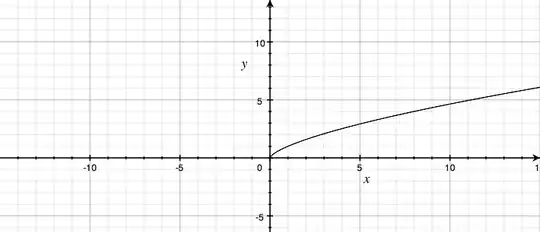

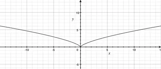

I'm trying to graph $x^{2/3}$. If I enter $y=x^{2/3}$, my graphing program excludes negatives from the domain: x to the two-thirds However, if I enter it as either $y=\sqrt[3]{x^2}$ or $y=(x^{1/3})^2$, it includes the negative values of $x$: cube root of x-squared
I'd like to understand what's going on. My best guess is that while $x^{2/3}$ is well defined for negative values of $x$ (since the fractional exponent's denominator is an odd integer), the graphing program is being overly cautious in interpreting the expression. But that's just a guess. Any ideas what's happening here?

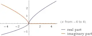

WolframAlpha: $y = x^{2/3}$:

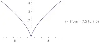

WolframAlpha: $y = \sqrt[3]{x^2}$:
Note: the scales for graphing are different, but there is clearly a difference with respect to how Wolfram interprets each of the inputs. And the first plot adds an additional anomaly.
amWhy
  • 210,739
  • That 1st plot is trying to show 3D of data in just 2D. The imaginary part (x<0) should be added to the real part to produce a curve in [x,y,z] space. – amI Oct 17 '16 at 21:17
