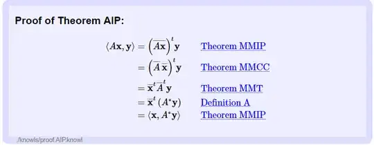

OK, I have to leave the OP with something better than the above. If you want to give $\text{(0)}$ a name, call it Theorem AIP and refer to this link.
Below I copy the theorem and the proof. As an exercise, the OP can restate all the definitions/theorems/proofs by replacing the complex numbers with the real numbers, where for $x \in \Bbb R$, $\,\bar x = x$. While working on this, the OP can attempt to attach geometric intuitions to the ideas and concepts as they are analyzed.
Theorem AIP: Adjoint and Inner Product. Suppose that $A$ is an $m \times n$ matrix and $\vec x \in {\Bbb C}^n$, $\vec y \in {\Bbb C}^m$. Then
$$\tag 1 \langle A \vec x, \vec y\rangle = \langle \vec x, A^{*} \vec y\rangle$$
Proof
