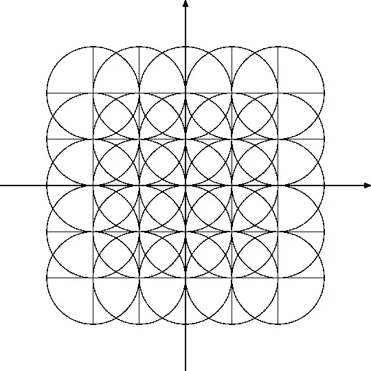

The following picture shows circles with radius one around each lattice point from $\mathbb Z[i]$, to find $q$ we basically check whether $\frac rb$ belongs to one of these circles.

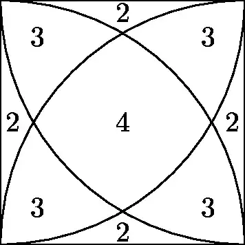

We can see that the $q$ is not necessarily uniquely determined. Depending on the position of $\frac rb$ in the squares determined by $\mathbb Z[i]$ we can have up to four possibilities.
Question. For a given $b\in\mathbb Z[i]$, what are the numbers of possibilities we can get for $q$? For example, what is the characterization of $b$'s such that, depending on $a$, we can have either one or four possible choices for $q$ in $(1)$? What is the characterization of $b$'s such that for some $a$'s we might have only one choice, for other $a$'s we can get two choices, and there are also $a$'s with for possible choices for $q$? What are $b$'s such that (depending on $a$) we might get one, two, three or four choices for $b$?
If we look at the interpretation explained in $(2)$, we are basically asking whether there are linear combinations of $\frac1b$ and $\frac ib$ which belong to areas denoted by $1$, $2$, $3$, $4$ of some square in the grid.
