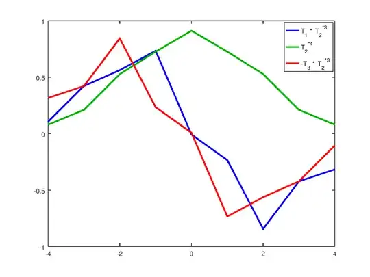

We can see first and third rows are meanless and only one zero crossing. This make them in some sense derivative-approximators. However they are clearly skewed. The top one to the right and the bottom to the left. If we as usually in signal processing is done iterate low pass filter a few times for each row, we get the following convolution kernels:
Green is the low-pass channel, a weighted average bell-like curve. Blue is first order derivative of kind one, slightly "diffused" to the right. Red is first order derivative of kind two, slightly "diffused" to the left.
