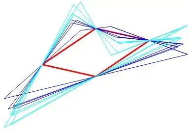

Fig. 1 : The given parallelogram (in red). Whatever the departure point $M$, once 4 central symmetries have been applied, one falls back on $M$. The generated parallelogram is convex (deep blue) iff "the vertices are in the regions bounded by three edges (extended) of the parallelogram" (thanks to @Ethan Bolker for this remark).

As pointed out by others, it is a necessary condition that the points form a parallegram. I will adress here the fact that there is an infinity of solutions, and even more, that any point in the plane can be chosen as one of the vertices of the parallelogram.
The easiest way to see it is by using the complex expression
$$z'=S_c(z)=2c-z\tag{1}$$
of central symmetry $z \to z'$ (with point $c$ as the center) ; (1) comes from constraint $c=\dfrac12(z+z').$
Let us consider the case $n=4$ : combining 4 central symmetries (see figure) :
$$T(z)=2c_4-(2c_3-(2c_2-(2c_1-z)))=2(c_4-c_3+c_2-c_1)+z\tag{2}$$
But a necessary and sufficient condition for $c_1,c_2,c_3,c_4$ to be the vertices of a parallelogram is precisely $(c_4-c_3)+(c_2-c_1)=0$. Thus, in such a case, (2) becomes $T(z)=z$ ; whatever the beginning point $z$, once the 4 central symmetries have been done, we are back at point $z$. There are an infinite number of solutions.
A similar situation will happen for all even values of $n$... Nothing similar exist for an odd value of $n$.
