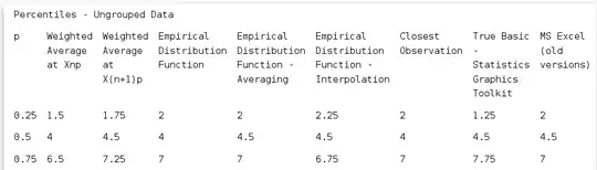

Let's review the results. For an analogue of the first case, set {1,2,3,4,5,6,7,8,9}, I got following results (the median is 5): enter image description here
It seems like the methods used to calculate the 50th percentile are based on definitions of percentiles that allow to percentiles to exist even for such set as {1,2,3,4,5,6,7,8,9}. I have no idea what these definitions are though.

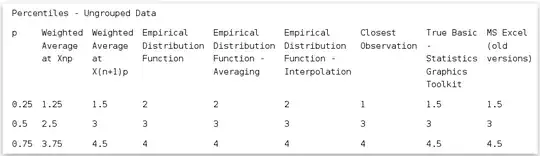

Now the second case, set {1,2,3,4,5} and the median is 3: enter image description here Only one method gave 50th percentile different from the median.

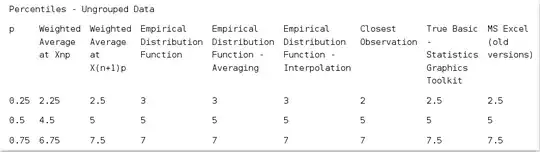

Now the third case, set {0,1,2,3,4,5,6,7,8,9} and the median is 4.5 enter image description here 3 methods gave result different from the median.
So, to summarize it all: Some methods can sometimes give the 50th percentile that is different from the median. Some methods never give 50th percentile that is different from the median. Some methods (I'm looking at you, "Weighted Average at Xnp"!) always give 50th percentile result that is different from the median. But even when 50th percentile is different from the median, the difference is relatively small. Probably the difference can be ignored altogether.
