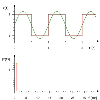

    (+1) Waves in general can be tied to complex numbers, as shown by the Fourier transform. So an electrical wave, an ocean wave or a fluctuation in the stock market can be related to complex numbers. I recently encountered complex numbers when I was processing some physiological data because it had waves in it. Complex numbers form a bridge between waves and exponential functions. Also, complex numbers and Fourier transforms can tie probability density functions with their characteristic functions. – Jam May 30 '19 at 11:05
  • 13
    This is true, but I'm not sure how comprehensible it would be to middle school students. – Joshua Frank May 30 '19 at 12:52
  • @JoshuaFrank I think they could appreciate the idea that oscillating signals have 2 qualities: their intensity and phase offset. The 2 parts can be represented by a complex number, which is fundamentally just a number with 2 parts (intensity and offset). Even if they don't understand the exact mechanics of it, they can still superficially appreciate the connection. I don't understand any of the intricacies of the Riemann Hypothesis but I understand that there's a connection between the zeta-function and the primes. – Jam May 30 '19 at 13:11
    The beauty of using complex numbers as phasors in this way is that you eventually reach the idea of impedence. The fact that you can treat all inductors and capacitors in the same way you treat resistors is where we see a lot of the power. If you have already taught resistors (with real numbers), teaching inductors and capacitors (with complex numbers) as precicely the same sort of thing might resonate. Fewer equations to memorize for the test! – Cort Ammon May 30 '19 at 18:52

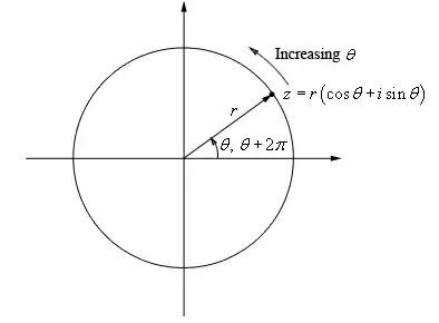

A complex number represents a rotation and a scaling and translation of another complex number.
That is about as physical as it gets in mathematics.
Given two complex numbers, a+b is translating a by b.
And a*b is rotating a by the angle of b, then scaling the result by the magnitude of b.

A physical example that should be comprehensible to bright 14 year olds. Fourier series and transforms can be used to describe functions and naturally produce complex numbers. I think complex numbers are easiest introduced by defining the solutions to $x^2+1=0$, analogously to negative numbers defining the solution to $x+1=0$. But it's good to have a physical example too.
Fourier series approximate periodic functions
Functions are ubiquitous in physics. Some functions can be periodic, for instance the red particles' positions as a function of time, $s(t)$, in the figure below.
Realistically, any function we observe will have some unexplained error. The red particles in the figure will not be moving perfectly back and forth due to other factors affecting their movement (e.g. buffeting about by the other particles).
So, if we wanted to interpolate $s(t)$ or find it's slope, we may want to approximate our periodic function with a simpler one. We would want to constrain this to a continuous function, since it is unrealistic for the particle to teleport through space. One natural choice is $\sin(t)$, since it's continuous and easy to define. But this doesn't quite solve the problem since $\sin(t)$ doesn't reflect the complex shape of $s(t)$. Hence, a sum of $\sin(t)$, with different amplitudes and frequencies could approximate $s(t)$ since it would have more potential for different shapes.*
The figure below shows what this looks like in practice, when we approximate the red $s(t)$ with the green sum of $\sin(t)$. The right amplitudes for each frequency of $\sin(t)$ are shown below. So we have successfully approximated a periodic function with a sum of $\sin(t)$ (Fourier series) that is easier to work with.
We can find explicit expressions for the amplitudes at each frequency that follows from the properties of $\sin$ and $\cos$. The proof might be slightly beyond your students' current skills but they could possibly go through it with a little help. Suffice it to say, we can look at the strength of each frequency in $s(t)$.
Fourier transforms generate complex numbers
The Fourier transform allows us to generalise this technique to approximate functions that are less obviously periodic (if at all) or to test whether they have periodicity. Just like with the Fourier series, we can say "how much" of each frequency makes up the function. This is particularly useful if we just want to describe the most important bits of our data. It's far easier to say "the red particle has a strong oscillation of $3\,\mathrm{Hz}$" than to describe its position at every single point in time.**
So, how does the Fourier transform find the strength of each frequency? We can't use the technique we used earlier with the Fourier series, since we don't know how our function is periodic. In order to proceed, we can describe the frequency of each wave that makes up the function by a certain strength (magnitude). But we must also know the phase-offset since $\sin(t)$ could be present as $\sin(t+1)$.
What system of numbers incorporates both a magnitude and a phase? The complex numbers do. Not only does a complex number have a 'size' (modulus), it also has an 'angle' (argument). So each frequency, with a magnitude and phase-offset, is naturally associated with a complex number, with a modulus and argument (as in the figure below). Hence, this is the output of the Fourier transform, if we adapt our earlier technique for Fourier series coefficients. This also requires some slightly difficult calculus.
Hence, complex numbers (via Fourier transforms) allow us to describe data with some semblance of "waves". This could be for physical waves (electromagnetic waves or wavefunctions) or abstract waves, such as relating the "frequencies" of the prime-counting function with the complex numbers of the Riemann zeta function.
To summarise, when we want to describe the important frequencies that make up a function, we must consider both the size and phase of each frequency, which corresponds with the modulus and argument of a complex number.
* The sum should include terms with both $\sin$ and $\cos$.
** This fact is the basis for .jpg and .mp3 file compression algorithms; another example of the utility of complex numbers.

Why not use space dimensions and cartesian coordinate frames to clarfy complex numbers? that is the most intuitive way to understand them that I came across when I was at middle school.
Imagine an ant in a 1-D world. The ant can travel only backwards or forwards and its position can be described by one real number x. In a parallel universe, we have ants living in a 2-D world. In this world, complex numbers can define a position of ants on a surface. A complex number x + iy describes an ant which traveled x front/rear and y sideways (left/right migh be easier for the kids to understand). And i is just there to indicate that that number describes movement on the second dimension.
Woudln't that satisfy the kids' imagination?
