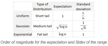

Here $X_1,\cdots,X_n$ are i.i.d. The two extremes $B=0$ and $B=2$, and the standard case $B = 1$ are illustrated in the picture below. For the reference, see here.

  • I mean $E[R_n^2] - E^2[R_n]$ with $R_n = \max(X_1,\cdots,X_n) - \min(X_1,\cdots,X_n)$. The distribution of the range depends on the distribution of the $X_k$'s, the general formula can be found at https://math.stackexchange.com/questions/3236430/recurrence-formula-for-the-moments-product-moments-of-some-order-statistics/3236452#3236452. – Vincent Granville May 25 '19 at 05:13
  • Asking a question in the title (only) is not a proper way to ask. As for the question, the expected value can be infinite, so the variance may be even undefined. Even if it is defined, it does not have to converge to zero. – zhoraster May 25 '19 at 06:51
  • Actually, in the exponential case, it does not converge to zero: the variance of the range converges to $\pi^2/(6\lambda^2)$, see the reference I provided. So $B=0$ and this case is covered. But of course, you need to exclude cases such as the Cauchy distribution, that don't have an expectation to start with. – Vincent Granville May 25 '19 at 07:42
    Regarding the standard Cauchy distribution, the range does not have an expectation, but it has a median (equal to 2 if $n=2$.) At first glance, it seems that the median of the range is $O(n)$ in this case. In general, the order of magnitude for the expectation of the range is $F^{-1}(n/(n+1)) - F^{-1}(1/(n+1))$ where $F$ is the cdf attached to the $X_k$'s. – Vincent Granville May 25 '19 at 08:49
  • If you had $f(x)=ke^{-x^\alpha}$ for $x \gt 0$, then what happens for $\alpha$ just above $0$? – Henry May 25 '19 at 09:04
