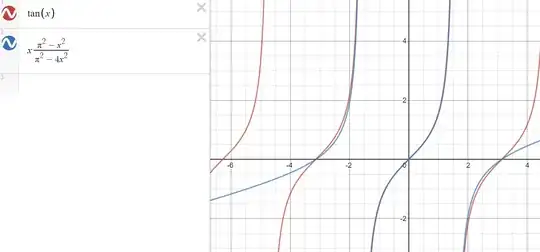

This is not an identity, but just an approximation for $\tan$.
If you look at their graphs, you'll notice that the two functions line up very, very well though for $|x|\leq\pi$.
