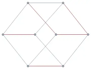

It is not true that three such cycles always exist; the cube graph is a counterexample. (Moreover, you are right that this is a hole in the proof; it is plausible that it might be NP-hard to test if a 3-connected planar cubic graph is Hamiltonian, but not NP-hard to test if a 3-connected planar cubic graph has a $3$-coloring in which any two color classes form a Hamiltonian cycle.)
This can be checked by brute force, since there are only six Hamiltonian cycles, and each of them looks like the following one up to an automorphism of the graph:
But once we draw a cycle, there is limited freedom to draw the two others, and we run into a contradiction quickly when we try to do it by hand.

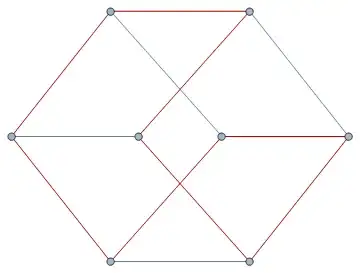

If $C_1$ is the cycle above, then $C_2$ and $C_3$ must both include the $4$ edges that are not part of $C_1$. In addition, one of $C_2$ or $C_3$ must include the horizontal edge in the middle right of the diagram, giving us the following five edges:
But these five edges cannot be completed to any Hamiltonian cycle, which is a contradiction.
