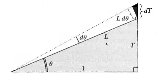

The following picture is taken from the book Visual Complex Analysis by Needham:
The author says that in the limit as $d\theta$ tends to zero, the black triangle is similar to the shaded triangle. I'm not sure what he means by black triangle and shaded triangle but I'm assuming the black triangle is the one with sides $dT$ and $Ld\theta$ and the shaded triangle is the the one with sides $L$ and $T$ and another side with length 1.
If so, why are they similar "in the limit"? How can we know that the dark black area tends to $0$ fast enough comparatively to the light black area?
Also, assuming they are indeed similar, then the angle between $L$ and $T$ is $90º-\theta$ so the angle between $Ld\theta$ and $dT$ should be $\theta$, right? Then shouldn't $\frac{dT}{Ld\theta} = \frac{1}{L}$? But in the book it says $\frac{dT}{Ld\theta} = \frac{L}{1}$...
