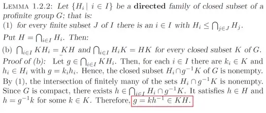

In the following image (from "Field Arithmetic by Fried & Jarden" Page 6, Lemma 1.2.2(b)), red rectangle,
I'm trying to figure out why it's right to claim $h^{-1} \in H$.
I thought the following solved it:
$g=k_ih_i$ and $g=kh^{-1}$ $\Rightarrow k_ih_i=kh^{-1} \Rightarrow h_ih=k_i^{-1}k \in H$ because right hand side is in H.
So $h^{-1}=k^{-1}g=k^{-1}k_ih_i$, hence, because $k_i^{-1}k \in H$ we get $h^{-1} \in H \Rightarrow g=kh^{-1} \in KH$.
But then I realized there's no logic in assuming $h_ih \in H$ because we're talking subsets here, not subgroups. So is it ok to assume $h_ih \in H$? if so, why?
If not, I'd appreciate an explanation for the red part..

  • The symbol $\leq$ is usually reserved for subgroups. It looks to me that they are asserting that $H_i$ is a subgroup of the finite intersection. – Arturo Magidin May 09 '19 at 17:14
  • P.S. It’s generally preferable not to post images, but rather to copy the text; images cannot be searched, and there are other interface issues with them. – Arturo Magidin May 09 '19 at 17:15
  • Appologies, I didn't know that.. – Khal May 09 '19 at 17:20
  • As I commented to user672573 below, $H_is$ are defined as subsets, not subgroups – Khal May 09 '19 at 17:25
  • I know, I can read. But later on, they use the symbol $\leq$, which, as I indicated, is normally reserved for subgroups; the property seems to suggest that your assumptions include that the $H_i$ are also subgroups. Otherwise, propery (1) would read “$H_i\subseteq \cap_{j\in J} H_j$” rather than “$H_i\leq \cap_{j\in J} H_j$”. Which I thought was clear from the syntax of my sentence. – Arturo Magidin May 09 '19 at 17:37
  • I get you, however, even if we assume that's correct, it relates only to a finite subset J of I, while the proof refers to any i in I. – Khal May 09 '19 at 17:43
  • And if $J={i}$, it follows that you either get $H_i$ is a subgroup, or else that there is an $H_{i’}$ contained in $H_i$ which is a subgroup, so if you replace $H$ with the intersection of all $H_i$ which are subgroups, you get the exact same intersection. – Arturo Magidin May 09 '19 at 17:55
  • You're assuming that this method will cover all $H_is$ but in fact, it can be that for each $J$ as you mentioned, the subgroup will be only H_1 and so the intersection will contain only H_1 as oppose to all $H_is$ as required. – Khal May 09 '19 at 18:42
    If you always get $H_1$, then you get that $H_1$ is contained in $H_j$ for all $j$, so that the intersection would actually be contained in all $H_j$. Look: define $H$ to be the intersection over all $i$ for which $H_i$ is actually a subgroup. I claim that $H$ is contained in the intersection of all $H_j$. To prove that, let $j\in I$ be fixed. Then by the condition given, there exists $i\in I$ such that $H_i$ is a subgroup of $\cap_{j\in{j}}H_j = H_j$. Thus, $H\subseteq H_i\leq H_j$. Hence, $H\subseteq H_j$. This proves the claim. – Arturo Magidin May 09 '19 at 18:51
  • In other words, you conditions guarantees that you have a cofinal subset of $I$ that indexes subgroups. Since the limit over a cofinal subset is equal to the whole limit, you can replace your original set with the set of all $H_i$ that are subgroups and get the exact same result. – Arturo Magidin May 09 '19 at 18:53
  • @ArturoMagidin I agree to you concerning the use of $\le$. However, the result is true for arbitrary closed $H_i$ and $\subseteq$. The proof contains a silly mistake. See my answer. – Paul Frost May 10 '19 at 12:53
  • @ArturoMagidin I agree (using your notations) that $H \subseteq H_i \le H_j$ as you wrote. what makes you say that it's actually $H=\bigcap_{j \in I}H_j$? There can still be $h \in \bigcap_{j \in I}H_j$ s.t. $h /\in H$.. what am I missing? – Khal May 10 '19 at 13:40
  • I don't understand what your issue is, and the comment thread is way too long. If you replace your family with the family of $H_i$ that are actually subgroups, you get the exact same intersection and the argument, if correct, would go through. Your objections continually miss the fact that, under the assumption I understood to be happening, you can replace any $H_j$ with a smaller $H_{j'}$ which is a subgroup, so that you can argue with subgroups throughout. Though as Paul Frost noted, that is immaterial. – Arturo Magidin May 10 '19 at 15:48
The proof is not correct.
You have $g = k_ih_i$ with $k_i \in K, h_i \in H_i$. But then $h_i = k_i^{-1}g \in K^{-1}g$ and we conclude $H_i \cap K^{-1}g \ne \emptyset$ and not $H_i \cap g^{-1}K \ne \emptyset$. But then we can correctly show that there exists $h \in \bigcap_{i \in I} (H_i \cap K^{-1}g) = (\bigcap_{i \in I} H_i) \cap K^{-1}g = H \cap K^{-1}g$. Hence $h \in H$ and $h = k^{-1}g$ for some $k \in K$. This means $g = kh \in KH$.
Paul Frost
  • 87,968
  • Seems legit. Thanks!
    What can you say about the $\le$? I'm still not sure if it's meant to show $H_i$ is a subgroup of the intersection or if it's just the binary relation $\subseteq$ that comes from the "directedness" of the family of subsets.
    – Khal May 10 '19 at 13:12
    I believe Arturo Magidin is right: $\le$ is a relation for subgroups. But I do not know your book, perhaps the author uses $\le$ also for subsets or perhaps it is a typo. Anway, the result is correct for $\subseteq$. – Paul Frost May 10 '19 at 13:16
  • But if $A \le B$ is really intended to denote the subgroup relation, then it only makes sense to use it if $B$ is a group and $A$ is a subgroup. This would implicitly say that all $H_i$ are subgroups (take $J = { i }$). This would not fit to the assumption the $H_i$ are subsets. – Paul Frost May 10 '19 at 13:28
  • That I can't understand. Why would that imply $H_i$ are all subgroups? – Khal May 10 '19 at 13:42
  • Take $J ={ i' }$. The assumption implies that there is $i$ such that $H_i \le \bigcap_{j \in J} H_j = H_{i'}$. Hence $H_{i'}$ must be a subgroup if you use $\le$ "correctly". – Paul Frost May 10 '19 at 13:47
  • Oh and by that $H_{i'}$ would have to be a group.. got it :) – Khal May 10 '19 at 13:51
    I had a look into your book. On the preceeding pages the authors use $\subseteq$ for set inclusion. On p..5 $\le$ occurs for (closed normal) subgroups, this indicates that it is in fact used as the subgroup relation. Also part (a) of the Lemma gives a hint that the $H_i$ are intended to be subgroups. – Paul Frost May 10 '19 at 13:56
  • So by our recently acquired logic, each $H_i$ (element of the intersection) is in fact a subgroup itself and then it's ok to assume they're closed under inversion. Thanks for the help and patience @Paul Frost! – Khal May 10 '19 at 14:02
    But note that the correct proof of (b) does not require that $H$ is closed under inversion ;-) We only need to know that $K^{-1}$ is closed which is due to the continuity of the inversion. – Paul Frost May 10 '19 at 14:05
