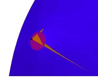

  1. Show that the geodesics of part (2) are sent by $h$ to straight lines in the Klein model. (The map $h$ is a stereographic projection along lines through the origin, to $D^n \subset \{x_0 = 1\} \subset L^{n+1}$).The stereographic projection to the disk of a geodesic segment

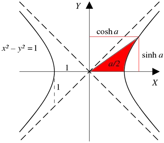

This is not the fastest way to see this but it connects the geometric reasoning to a formula and you can understant the arrcosh function. Maybe now you will even be satisfied with the $arrcosh$ formula without the calculation. Because you can understand what we are measuring.
