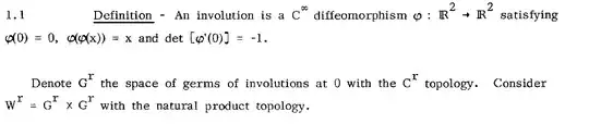

I'm studying the paper "Local and simultaneous structural stability of certain diffeomorphisms. - Marco Antonio Teixeira". At the beginning of the paper, the author gives the following definition enter image description here

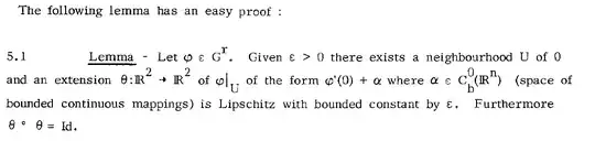

Besides that, the author states the following lemma: ![enter image description here
However, he does not demonstrate such a result, just saying "the lemma is easy to proof".
I know how to find an extension $\omega:\mathbb{R}^2\to \mathbb{R}^2$ of $\left. \varphi \right|_{U}$ such that $\varphi'(0) + \beta$ where $\beta \in \mathcal C_b^0 (\mathbb{R}^2)$ is Lipschitz with bounded constant by $\varepsilon$. However, I don't have the faintest idea how to guarantee $\omega\circ \omega= \mathrm{Id}.$

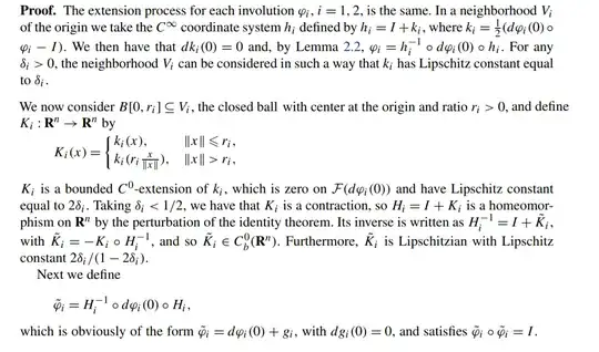

There is a proof of this statement in the paper "Simultaneous linearization of a class of pairs of involutions with normally hyperbolic composition - Marco Antonio Teixeira, Solange Mancini, Miriam Manoel".
I made some edits in the image below since the content that answers my question is just a part of the proof of Lemma $4.2$. I have erased all the information that is not related to the problem that I wanted to solve.
