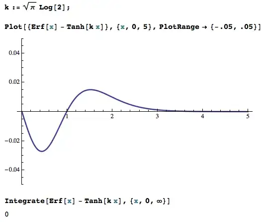

$\int_0^\infty\text{erf}(x)-f(x)dx,$
i.e. the difference of the functions areas, should valish. With this value, the maximal value difference even falls under $|\Delta f| = 0.03$. And however you choose the integration bounds for an interval, the area difference is no more than $0.017$.
Numerically speaking and relative to a unit scale, the functions $\text{erf}$ and $\tanh{(\sqrt{\pi}\log{(2)}x)}$ are essentially the same.

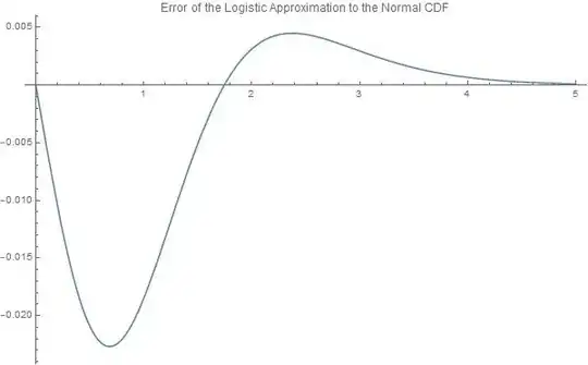

Mathematica to analyze errors:
Define:
normsdistApprox[X_] = (1/2 + 1/2 Tanh[(\[Pi] X)/(2 Sqrt[3])])
normsinvApprox[p_] = X /. Solve[ p == normsdistApprox[X]  , X][[1]]
normalPDFApprox = D[normsdistApprox[X], X]

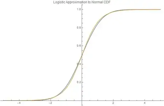

Plot:
Plot[{CDF[NormalDistribution[], X], normsdistApprox[X]}, {X, -5, 5},
 PlotLabel -> "Logistic Approximation to Normal CDF",
 PlotLegends -> "Expressions", ImageSize -> 600]
Plot[{Abs[CDF[NormalDistribution[], X] - normsdistApprox[X] ]}, {X, 0,
   5}, PlotLabel ->
  "Error of the Logistic Approximation to the Normal CDF",
 ImageSize -> 600]

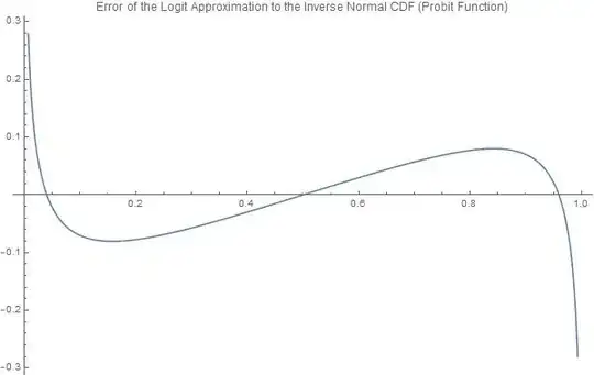

Plot[{InverseCDF[NormalDistribution[0, 1], p], normsinvApprox[p]}, {p,
   0, 1}, PlotLabel ->
  "Logistic Approximation to the Inverse Normal CDF (Probit \
Function)", PlotLegends -> "Expressions", ImageSize -> 600]
Plot[{InverseCDF[NormalDistribution[0, 1], p] -
   normsinvApprox[p]}, {p, 0, 1},
 PlotLabel ->
  "Error of the Logit Approximation to the Inverse Normal CDF (Probit \
Lastly, give max errors:

FindMaximum[{Abs[
   InverseCDF[NormalDistribution[0, 1], p] - normsinvApprox[p]],
  p >= 1*10^-2, p <= 1 - 1 *10^-2}, p]
FindMaximum[{Abs[
  p >= 1*10^-16, p <= 1*10^-2}, p]
Out:
{0.0226628, {X -> 0.682761}}
{0.0802364, {p -> 0.841941}}
{12.032, {p -> 1.*10^-16}}

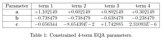

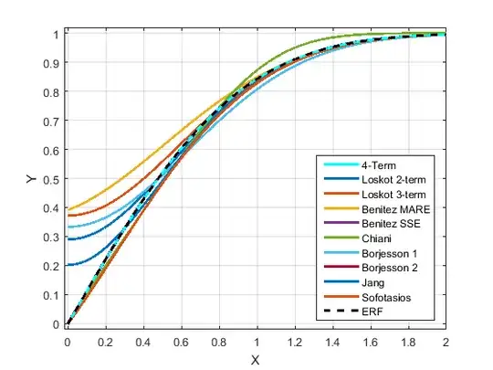

Late comer to this question but I know several solutions that may be of interest, including one that I am in the process of publishing. You seek an approximation to erf(x) that is "compact/rememberable" in the context of integrating a function presumably involving erf(x). I have been looking at just such a problem and the solution I came up with involves only exponentials of quadratic functions of the form $$ {\rm erf}_M(x)=1-\sum_{i=1}^{M} c_i {\rm e}^{-a_i x^2+2b_i x},~x\in R $$ where $a_i$, $b_i$ and $c_i$ for i=1...M are parameters that are used to fit the function erf(x). I call this an exponential quadratic approximator (EQA) for the error function. Note that the approximation can also be used for negative arguments since erf(x) is an odd function, which makes it applicable to the entire real line.
In the paper, I give an example for $M=4$ that yields a maximum absolute error of around $1.65 \times 10^{-4}$ on the entire real line. The 12 parameters are obtained by gradient descent optimisation. The values that give the cited error are given in Table 1:
enter image description here A preprint of the paper is available here: A 4-Term Exponential-Quadratic Approximation for Gaussian Q or Error Functions.
Comparison of approximations to the error function
The paper also reviews a number of other approximations from other researchers, although they are typically for the Gaussian Q-function $Q(x)=\frac{1}{2}(1-{\rm erf}(x/\sqrt{2}))$ and accurate for large $x$ but not near $x=0$, whereas the aforementioned EQA is exact at $x=0$. In the above figure, the 4-term EQA (dashed cyan) lies atop the error function (in black) on the graph. The other approximators, some of which are also based on exponentials of quadratic arguments, are detailed in the paper.

Too long for a comment.
The term $k_0=\sqrt \pi \log(2)$ is really elegant.
If we consider the norm $$\Phi(k)=\int_0^\infty \Big[\text{erf}(x)-\tanh (k x)\Big]^2\,dx$$ which corresponds to a least squares regression based on an infinite number of data points, we get a slightly different optimum value, which, rationalized, is $k_1=\frac{605}{503}$ (which is more than trivial). $$\Phi(k_0)=5.28 \times 10^{-4} \qquad \qquad \qquad \Phi(k_1)=4.44 \times 10^{-4}$$ In terms of maximum absolute errors, $k_0$ leads to $0.027$ while $k_1$ leads to $0.019$.
