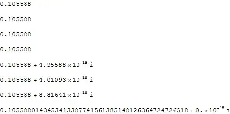

Clear[F]; Clear[FF];
F[z_, a_, b_] :=
  Log[a + z] Log[(b + z)/(-a + b)] + PolyLog[2, (a + z)/(a - b)];
FF[A_, B_, a_, b_] :=
  Module[{result, ts, zs, zsp, zsm, eps = 10^(-15)},
   (*This is Integrate[Log[z+a]/(z+b),{z,A,B}] where all a,b,A,
   and B are complex. *)
   result = F[B, a, b] - F[A, a, b];
   ts = - (Im[(A + b) (Conjugate[b] - Conjugate[a])]/
     Im[(B - A) (Conjugate[b] - Conjugate[a])]);
   If[0 <= ts <= 1,
    zsp = A + (ts + eps) (B - A);
    zsm = A + (ts - eps) (B - A);
    result += -F[zsp, a, b] + F[zsm, a, b];
   result
{a, b, c, d} = RandomReal[{0, 3}, 4, WorkingPrecision -> 50];
NIntegrate[
 Exp[-a/2 x^2 - b/2 y^2 - c/2 z^2 - d/2 w^2], {x, 0, Infinity}, {y, 0,
   x}, {z, 0, y}, {w, 0, z}]
NIntegrate[
 Sin[th]/Sqrt[a b d (b + c Sin[th]^2)] ArcTan[
   Sin[th] Sqrt[d/(b + c Sin[th]^2)]], {th, 0, ArcTan[Sqrt[b/a]]}]
  1/Sqrt[a ] NIntegrate[
  u ArcTan[u] 1/((d - c u^2) Sqrt[d - (c + b) u^2]), {u, 0, Sqrt[
   d/ (a + b + c)]}]
 Sqrt[d]/(Sqrt[a ] (b + c))
  NIntegrate[
  Sin[phi] ArcTan[
    Sqrt[d/(c + b)] Sin[phi]] 1/(d - c (d/(c + b) Sin[phi]^2)) , {phi,
    0, ArcSin[ Sqrt[( c + b)/ (a + b + c)]]}]
- I 2/(Sqrt[a ] Sqrt[d])
  NIntegrate[
   t /(c (-1 + t^2)^2 + b (1 + t^2)^2) Log[(
    1 + t^2 + 2 I Sqrt[d/(b + c)] t)/(
    1 + t^2 - 2 I Sqrt[d/(b + c)] t)], {t, 0, Sqrt[(b + c)/(
   a + b + c)]/(1 + Sqrt[a/(a + b + c)])}]
  NIntegrate[
     b (1 + t^2)^2) Log[((1/
        2 (2 I Sqrt[d/(b + c)] - Sqrt[-4 - (4 d)/(b + c)]) +
       t) (1/2 (2 I Sqrt[d/(b + c)] + Sqrt[-4 - (4 d)/(b + c)]) +
       t))/((1/2 (-2 I Sqrt[d/(b + c)] - Sqrt[-4 - (4 d)/(b + c)]) +
       t) (1/2 (-2 I Sqrt[d/(b + c)] + Sqrt[-4 - (4 d)/(b + c)]) +
       t))], {t, 0, Sqrt[(b + c)/(a + b + c)]/(
 1/Sqrt[a b c d]  1/4 NIntegrate[
  Sum[(-1)^(Floor[(eta - 1)/2]) (-1)^
    Floor[(xi - 1)/2] Log[
     t + (-1)^Floor[(xi - 1)/2] I Sqrt[d/(b + c)] + (-1)^(xi - 1)
        I Sqrt[( b + c + d)/(b + c)]]/(
    t - (-1)^(1 + eta +
        Floor[(eta - 1)/2]) I Exp[(-1)^(Floor[(eta - 1)/2]) I ArcTan[
         Sqrt[c]/Sqrt[b]]]), {xi, 1, 4}, {eta, 1, 4}], {t, 0, Sqrt[(
   b + c)/(a + b + c)]/(1 + Sqrt[a/(a + b + c)])}]
 1/Sqrt[a b c d]  1/4 Sum[(-1)^(Floor[(eta - 1)/2]) (-1)^
   Floor[(xi - 1)/2] FF[0, Sqrt[(b + c)/(a + b + c)]/(
    1 + Sqrt[a/(
     a + b + c)]), (-1)^Floor[(xi - 1)/2] I Sqrt[d/(b + c)] + (-1)^(
      xi - 1) I Sqrt[( b + c + d)/(
      b + c)], -(-1)^(1 + eta +
        Sqrt[c]/Sqrt[b]]]], {xi, 1, 4}, {eta, 1, 4}]
Update: As a sanity check look at the case $a=b=c=d=1$. Then define: \begin{eqnarray} M1&:=&\left( \begin{array}{cccc} -1+\sqrt{3} & \sqrt{2} & \sqrt{2} & -1+\sqrt{3} \\ 1 & \sqrt{2-\sqrt{3}} & \sqrt{2-\sqrt{3}} & 1 \\ \sqrt{2-\sqrt{3}} & 1 & 1 & \sqrt{2-\sqrt{3}} \\ \sqrt{2} & -1+\sqrt{3} & -1+\sqrt{3} & \sqrt{2} \\ \end{array} \right)\\ M2&:=&\left( \begin{array}{cccc} \frac{1}{\sqrt{2}} & \frac{1}{2} \left(1+\sqrt{3}\right) & \frac{1}{2} \left(1+\sqrt{3}\right) & \frac{1}{\sqrt{2}} \\ \frac{1}{\sqrt{2}} & \frac{1}{2} \left(-1+\sqrt{3}\right) & \frac{1}{2} \left(-1+\sqrt{3}\right) & \frac{1}{\sqrt{2}} \\ \frac{1}{2} \left(-1+\sqrt{3}\right) & \frac{1}{\sqrt{2}} & \frac{1}{\sqrt{2}} & \frac{1}{2} \left(-1+\sqrt{3}\right) \\ \frac{1}{2} \left(1+\sqrt{3}\right) & \frac{1}{\sqrt{2}} & \frac{1}{\sqrt{2}} & \frac{1}{2} \left(1+\sqrt{3}\right) \\ \end{array} \right)\\ A1&:=&\left( \begin{array}{cccc} -\frac{\pi }{6} & \frac{\pi }{12} & -\frac{\pi }{4} & 0 \\ \frac{5 \pi }{6} & \frac{\pi }{12} & \frac{5 \pi }{12} & -\frac{\pi }{3} \\ -\frac{5 \pi }{12} & \frac{\pi }{3} & -\frac{5 \pi }{6} & -\frac{\pi }{12} \\ \frac{\pi }{4} & 0 & \frac{\pi }{6} & -\frac{\pi }{12} \\ \end{array} \right)\\ A2&:=&\left( \begin{array}{cccc} -\frac{\pi }{12} & \frac{\pi }{6} & -\frac{\pi }{6} & \frac{\pi }{12} \\ \frac{7 \pi }{12} & -\frac{\pi }{6} & \frac{\pi }{6} & -\frac{7 \pi }{12} \\ -\frac{\pi }{6} & \frac{7 \pi }{12} & -\frac{7 \pi }{12} & \frac{\pi }{6} \\ \frac{\pi }{6} & -\frac{\pi }{12} & \frac{\pi }{12} & -\frac{\pi }{6} \\ \end{array} \right) \end{eqnarray} and we have \begin{eqnarray} I(1,1,1,1)=\frac{1}{4} \sum\limits_{\xi=1}^4 \sum\limits_{\eta=1}^4 (-1)^{\left\lfloor \frac{\eta -1}{2}\right\rfloor +\left\lfloor \frac{\xi -1}{2}\right\rfloor } \left( Li_2(M1_{\xi,\eta}\exp(\imath A1_{\xi,\eta}))- Li_2(M2_{\xi,\eta}\exp(\imath A2_{\xi,\eta})) \right) \end{eqnarray} We have checked numerically that this quantity above coincides with $\pi^2/96$ to one hundred digits. It would be interesting to prove this analytically.

    This is an impressive amount of algebra, but looking at Your Mathematica code at the end we're still left with one integral to be computed. It's unclear to me how is this more efficient than the original integral. What were we going for here? – Radost Waszkiewicz Apr 30 '19 at 16:03
    @Radost Sorry, the code was outdated. Now the code uses no numerical integrals. You can easily get the result with fifty digits of accuracy as I do above. But going back to your point I have played around with integrals like that many times. They simply reduce to poly-logarithms. there is no way around that. Yet polylogarithms can be computed with arbitrary precision whereas your original integral cannot. – Przemo Apr 30 '19 at 16:22
