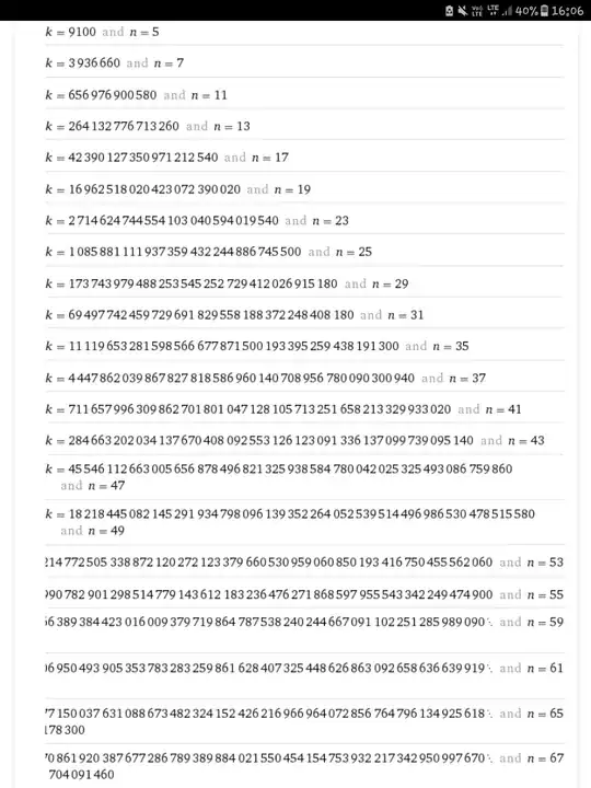

Solve the following... $309|(20^n-13^n-7^n)$ in $\mathbb{Z}^+$.

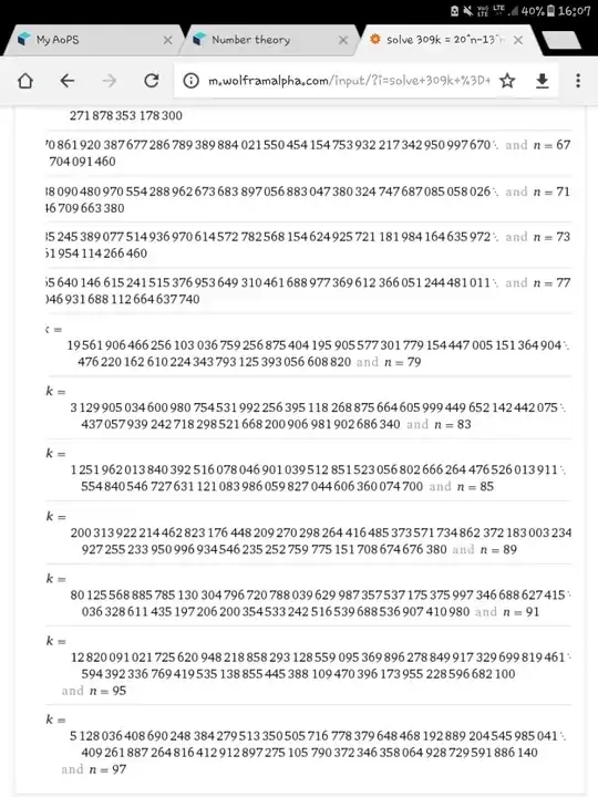

I invested lotof time to it and finally went to WolframAlpha for help by typing...
Solve $309k=20^n-13^n-7^n$ over the integers. It returned the following...
Note that all the primes are generated here. Can someone please explain why? Thanks! EDIT: the formulas suggested in the answerare too complicated, but this is so simple!
