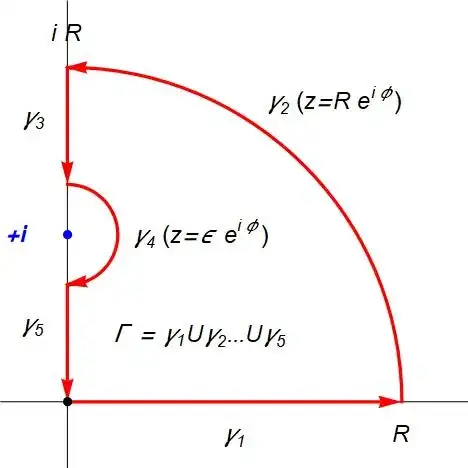

using contour integration. It is almost identical to the attempt of the OP but I use a slightly modified version of the contour 2 of the OP and it looks like that:
The path of integration is the closed contour $\Gamma =\gamma_1 + \gamma_2 + \gamma_3 + \gamma_4 + \gamma_5$
As there are no singularities of $f(z)$ included in or on the contour $\Gamma$ the integral over the contour is zero by means of Cauchy's theorem.
In the following, and integral corresponding to the path $\gamma_k$ is called $I_k$.
Cauchy's theorem then means just that $\sum_{k=1}^{5} I_k = 0$.
What follows is a comprehensive description of the paths in question:
$\gamma_1$ = positive real axis from $x=0$ to $x=R >1$ (in the limit $R \to \infty$ this becomes the integral I(a))
$\gamma_2$ = quarter circle of radius $R(>1)$ in mathematical positive direction from $R$ to $i R$. With the parametrization $z=R e^{i \phi}$, $dz = R e^{i \phi} d\phi$, $\phi = 0 \cdots \pi/2$ we get
$$I_2 = \int_{0}^{\pi/2} R e^{i \phi} \frac{e^{i a R e^{i \phi}}}{1+R^2 e^{i \phi}} \;d\phi\tag{2a}$$
We can estimate the modulus of $I_2$ as follows
$$\begin {align}|I_2|& \le \int_{0}^{\pi/2} R |e^{i \phi}| \frac{|e^{i a R e^{i \phi}}|}{|1+R^2 e^{i \phi}|} \;d\phi = \int_{0}^{\pi/2} R \frac{|e^{i a R cos(\phi) + i a R (i sin(\phi) }|}{|1+R^2 e^{i \phi}|} \;d\phi\\&=\int_{0}^{\pi/2} R \frac{e^{- a R sin(\phi) }}{|1+R^2 e^{i \phi}|} \;d\phi \le \int_{0}^{\pi/2} R \frac{1}{|1+R^2 e^{i \phi}|} \;d\phi\\ &\le \int_{0}^{\pi/2} \frac{R}{R^2-1} \;d\phi=\frac{\pi}{2} \frac{R}{R^2-1}\end{align} \tag{2b}$$
In the last step we have used the inverse triangle inequality $|A+B| \ge ||A| - |B||$.
Hence we have obtained that $|I_2|\le \frac{\pi}{2}\frac{R}{R^2-1} $, and we conclude that $I_2$ vanishes in the limit $R\to \infty$.
$\gamma_3$ = imaginary axis from $z=i R$ to $z=i(1 + \epsilon)$, $0 \lt \epsilon <<1$. The parametrization $z = i y$, $dz=i dy$, $y=R \cdots (1+\epsilon)$ leads in the limit $R \to \infty$ to
$$I_3 = - i \int_{1+\epsilon}^{\infty} \frac{e^{- a y}}{1-y^2}\;dy\tag{3}$$
$\gamma_4$ = small half circle of radius $\epsilon$ avoiding the pole at $z=i$ The parametrization $z = i + \epsilon e^{i \phi}$,$dz =i \epsilon e^{i \phi}d\phi $, $\phi = \pi/2 \cdots (-\pi/2)$) leads to
$$I_4 = - i \epsilon \int_{-\pi/2}^{\pi/2}e^{i \phi} \frac{e^{i a (i+ \epsilon)e^{i \phi}}}{1+(i + \epsilon\; e^{i \phi})^2} \;d\phi\tag{4a} $$
For $\epsilon \to 0$ this becomes
$$I_4 = -\frac{1}{2} \int_{-\pi/2}^{\pi/2} e^{i a (i)}\;d\phi =- \frac{\pi}{2} e^{-a}\tag{4b}$$
$\gamma_5$ = imaginary axis from $z=i(1-\epsilon)$ to $z=0$.
The parametrization $z = i y$, $dz = i dy$, $y = 1-\epsilon \cdots 0$ leads, similar to $I_3$, to
$$I_5 = - i \int_{0}^{1-\epsilon}\frac{e^{- a y}}{1-y^2}\;dy\tag{5}$$

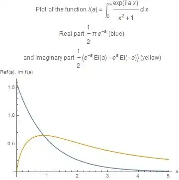

$$\Im(I(a)) = \frac{1}{2}\left(e^{-a} \text{Ei}(a)-e^{a} \text{Ei}(-a)\right)\tag{8}$$

Finally, here is a plot of the integral $I(a)$
