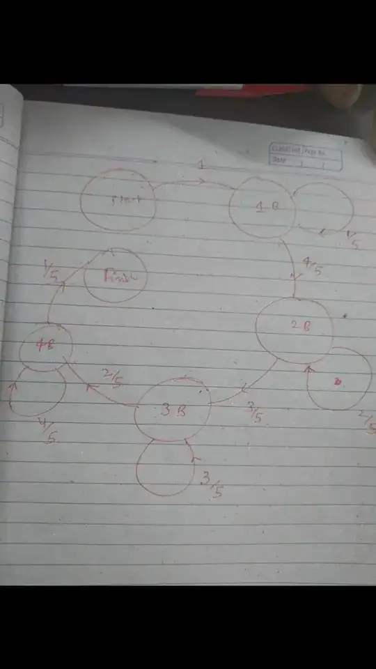

I have posted a state diagram representing the game, as a hint. Hope this helps. If you're still not able to understand, please leave a comment and I'll be happy to help.
PS: The text in the circles represents the state we are in, i.e., how many balls have been colored blue. The number on the lines is the probability that we'll go to another state or stay in the same state.
