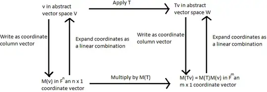

In answer to your second question, consult the following commutative diagram (made in Paint :( ):
The process of applying $T$ to a vector $v \in V$ is the top row of the diagram. However, there's a parallel process happening between $\Bbb{F}^n$ and $\Bbb{F}^m$, mirroring the same process.
The isomorphism being referred to are the double arrows, taking us between $V$ and $\Bbb{F}^n$ and $W$ and $\Bbb{F}^m$, by way of coordinate vectors. The coordinate vector map on $V$ is a linear map between $V$ and $\Bbb{F}^n$ that is invertible, making it an isomorphism (and similarly for $W$). That is, the two spaces are structurally identical, and anything we can do with one space, we can view it in the other.
In $V$, we have some abstract vectors, and an abstract linear transformation $T$ that maps vectors in $V$ to vectors in $W$. However, using this isomorphism, we can view $V$ slightly differently as $\Bbb{F}^n$, and similarly for $W$, which means $T$ boils down to a linear map from $\Bbb{F}^n$ to $\Bbb{F}^m$, which can be characterised as matrix multiplication. The matrix, in particular, is $M(T)$.
