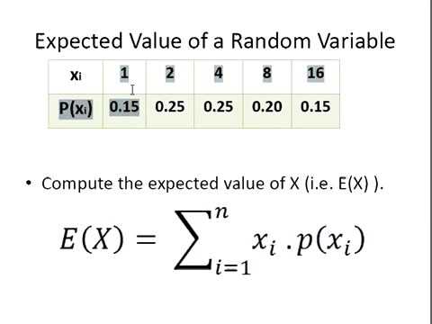

I new to probabilistic, so this may be an easy problem. The only formula that I know is this: formula, but I don't know how to use it here.
So my question is: How to calculate the expected number of jumps (with the given formula? What are $X_i$ and $p$ in this situation?)?
