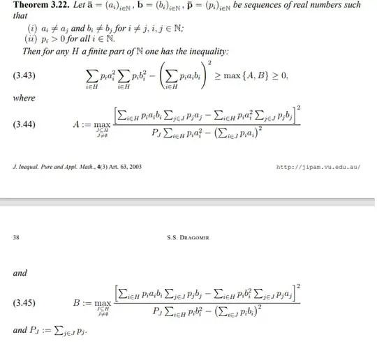

Following the proof @Andreas using CBS we have the following refinement :
CBSRefinement
Particular case :
If $p_i=1$ ,$\sum_{i\in J }a_jp_j=0$ ,$\sum_{i\in H }p_ia_i^2=2n$,$\sum_{j\in J}p_jb_j=2$, $P_j=2$ ,$\sum_{i\in J} p_ia_i=0$
Then we can take the value :
$$A=4n$$
Second example :
If $p_i=\frac{1}{n}$ ,$\sum_{i\in J }a_jp_j=0$ ,$\sum_{i\in H }p_ia_i^2=2n$,$\sum_{j\in J}p_jb_j=\frac{1}{n}$, $P_j=\frac{1}{n}$ ,$\sum_{i\in J} p_ia_i=0$
We can take the value :
$$A=2n$$
This result is almost equivalent to the proof @Andreas.
Reference :
@article{Dragomir2003ASO, title={A Survey on Cauchy-Buniakowsky-Schwartz Type Discrete Inequalities}, author={Sever Silvestru Dragomir}, journal={Mathematics eJournal}, year={2003} }
https://www.semanticscholar.org/paper/A-Survey-on-Cauchy-Buniakowsky-Schwartz-Type-Dragomir/4ef9912775e7c66ee1cb13b93270a8c8c79a67f4
