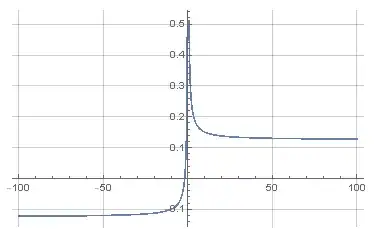

In front of every sqrt radical sign there is always a $\pm$ which is ignored and hidden when context is for magnitude only.
$\pm$ can be read as "plus and minus" as well...like in this context
$$\lim_{x\to\infty} \dfrac {x+2} {\pm\sqrt{64x^2+1}}$$
equals
$$\lim_{x\to-\infty} \dfrac {1+2/x} {\pm\sqrt{64 +1/x^2}}$$
equals both of
$$\pm\frac{ 1}{8} $$
which is valid when x tends to infinity towards right and left asymptotic ends respectively seen also graphically.
