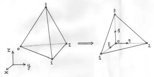

Linear Tetrahedron
Let's consider at first the simplest non-trivial finite element shape in 3-D, which is a linear tetrahedron.
Piece of theory for the Linear Thetrahedron has been developed here:
The following formula is recalled from that MSE reference: $$ T - T_0 = A.(x - x_0) + B.(y - y_0) + C.(z - z_0) $$ What kind of terms can be discretized at the domain of a linear tetrahedron? In the first place, the function $T(x,y,z)$ itself, of course. But one may also try on the first order partial derivatives $\partial T / (x,y,z)$. From the above definition of $(A,B,C)$ we have: $$ \frac{\partial T}{\partial x} = A \quad ; \quad \frac{\partial T}{\partial y} = B \quad ; \quad \frac{\partial T}{\partial z} = C $$ Using the matrix expression which was found in the reference for $(A,B,C)$: $$ \begin{bmatrix} \partial T / \partial x \\ \partial T / \partial y \\ \partial T / \partial z \end{bmatrix} = \begin{bmatrix} x_1-x_0 & y_1-y_0 & z_1-z_0 \\ x_2-x_0 & y_2-y_0 & z_2-z_0 \\ x_3-x_0 & y_3-y_0 & z_3-z_0 \end{bmatrix}^{-1} \begin{bmatrix} T_1-T_0 \\ T_2-T_0 \\ T_3-T_0 \end{bmatrix} $$
