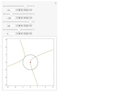

May not be the answer you are looking for, and probably not the forum for it, but you can plot the two curves using software, for example Mathematica or MATLAB or Python or Java or ...
Here is a quick way to do it in Mathematica, for example:
 a[x_, y_] := (x^2 + y^2 - 1);
 b[x_, y_][A_, B_, C_, D_] := (A x^2 + 2 B x y - A y^2 + C x + D y );
 c = 3;
 Manipulate[
    Show[ContourPlot[{a[x, y], b[x, y][A, B, C, D]}, {x, -c, c}, {y, -c, c}],
      Graphics[{Red, PointSize -> Large, Point[{0, 0}]}]],
        {A, -2, 2}, {B, -2, 2}, {C, -2, 2}, {D, -2, 2}]
You can also explicitly ask for the solutions:
With[{A = 1.15, B = -1.29, C = 1.95, D = 0},
  NSolve[{a[x, y] == 0, b[x, y][A, B, C, D] == 0}]]
This returns:
{{x -> 0.689595, y -> 0.724195}, {x -> 0.230435, y -> -0.973088},
 {x -> -0.871638, y -> 0.490151}, {x -> -0.799246, y -> 0.601004}}
