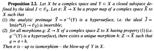

The following proposition is from Grauert-Peternell-Remmert's Several Complex Variables, VII, page 291. The statement (2) is the universal property that you are looking for. Note that it is essentially the same as chapter II, Prop. 7.14 in Hartshorne in the algebraic setting.
