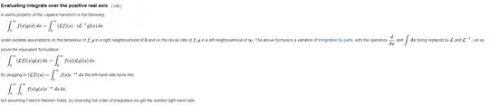

Well, we can look at the page of Laplace transform on Wikipedia to find the following:
